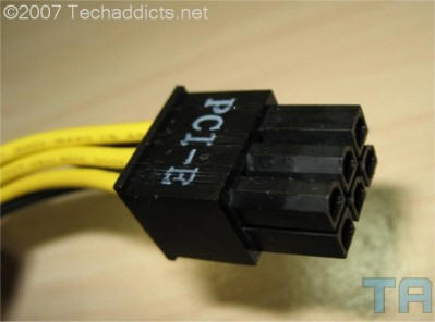

just making sure- have you connected the 6pin pci-e power connector to the gpu as well?(Assuming your psu has one)
