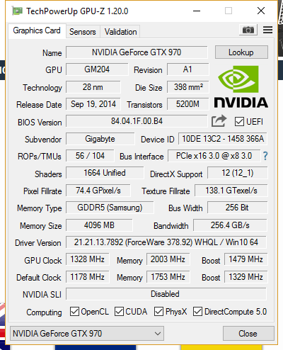

snapshot of GPUZ info:
http://gpuz.techpowerup.com/17/04/23/nqs.png

GIGABYTE GTX 970 GV-N970G1 4GD GAMING OC Edition GeForce 4GB 256-Bit GDDR5 PCI Express 3.0
