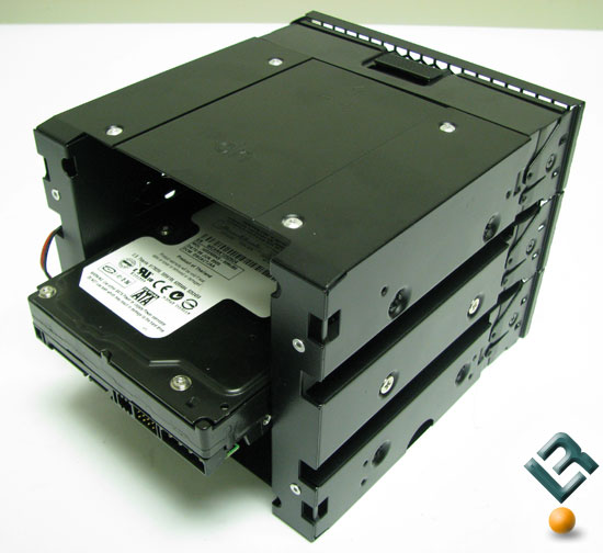

Actually im gonna install one of these
It will make internal drives hot swap from the front of my case. Then I can back up files with normal drives the same size as the array and they might even end up back in the array should a drive fail.
