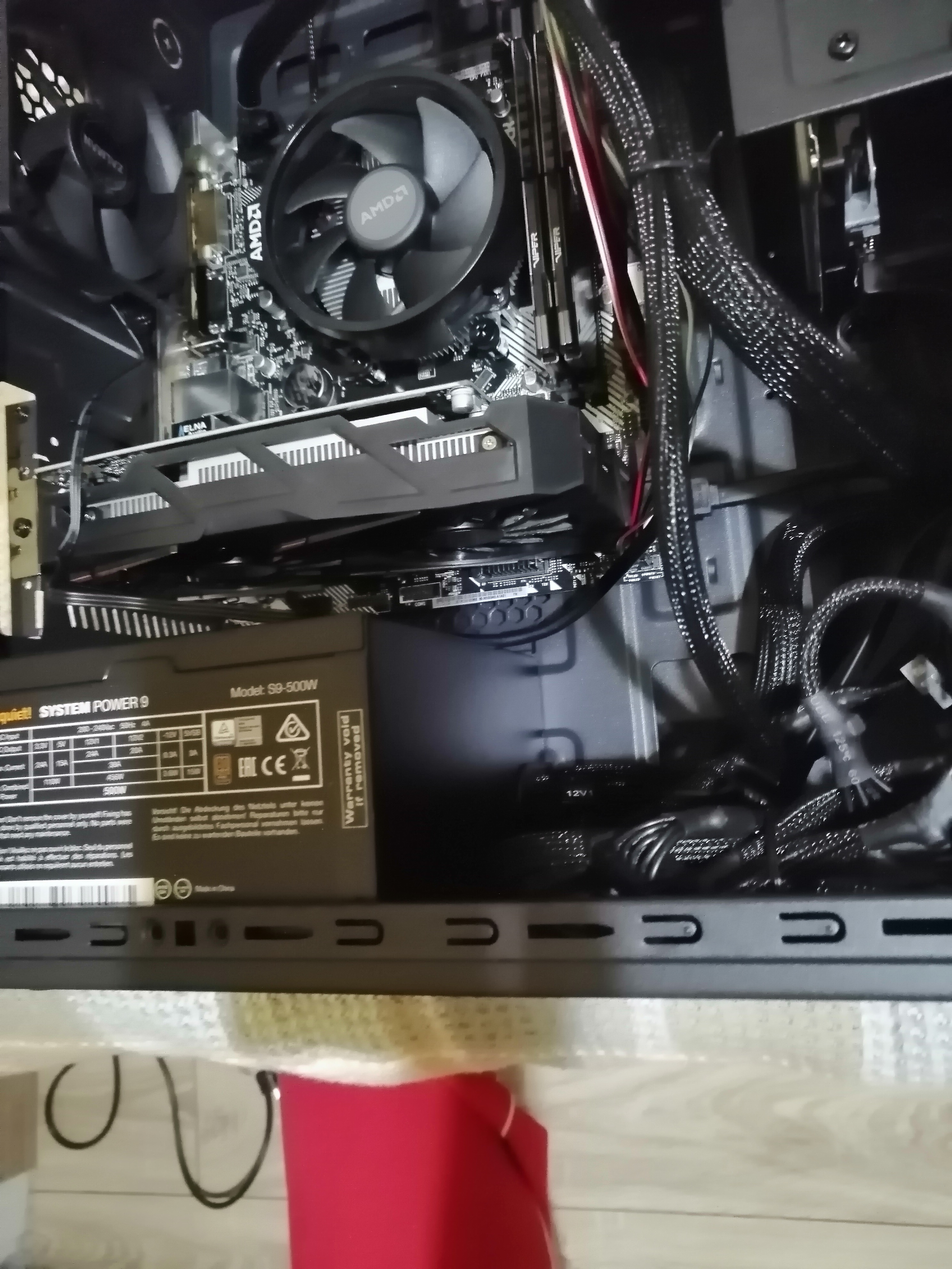

Hey, i just re-installed everything. I installed the motherboard using the standoffs(i used all the standoff holes i can use on the case, the others were not covered by the mobo), used a hair dryer to clean-up.
The thing is, i tried really hard to layer the screwholes in gpu to the screwholes in the case. Only one hole matched when i forced the gpu a little bit up. So i screwed it. But the problem is, the back of the gpu left open. I cant screw it because the screwhole is too loose, and cant snap it into place. Can i use it like that ? Will it cause me any trouble ? Photo of it is in the end of the post.The new look of Gpu screws are also in the end of the post.
Second is, i used plastic-like wire- string stuff i found in one of the components package to do cable managament.(it wasnt given to use for cable management) will this plastic cause a trouble any static-elektrik type of <mod edit> because im tired of thinking about it. Photos of the string-wires are at the end of the post.
Third is, the sound is still there and as i can hear its coming from cpu or something near that. maybe i should just ignore it as long as i dont see a performance problem.
Pics(i couldnt make them visible properly but just click them they're visible)

What do you think about the back of the gpu being left open(which you can see from pictures i attached in the last entry) do you think its fine, or should i close it somehow(even tho i cant...)

I would leave it open if the piece meant to be there won't fit properly.
If you have positive airflow in that case (more intake air than exhaust from fans) it will just exhaust air from the case.
And the plastic zip ties on your cables are fine.
I personally prefer not to use them because you have to cut them off if you need to work on the pc.
I prefer velcro straps (or plastic covered twist ties) but that's just a pet peeve of mine.

do you mind if i see a picture of the pc from a slightly far back shot so i can see the mother board power supply etc all in one
https://ibb.co/CP0bgyY
https://ibb.co/rw9tpgg
here are the pictures.
what do you think about the wires( plastic or nylon not sure) i used for cable management ? photos of them are two or three entries up.u think that might be a issue ?

You don't really need extra fans. Your PC is fine now. You said earlier that you don't have an OS yet. It's actually free to download and install Windows 10. All you need is a blank disc or usb stick. https://www.windowscentral.com/how-create-windows-10-usb-bootable-media-uefi-support do the Windows media creation tool option, ignore the Rufus option. If you use a blank disc, choose dvd and not flash drive where the option comes up.
May 23, 2019
29
35
I already have a bootable usb somewhere around, i just didnt install it yet. Im afraid to boot the pc because of the wires i used to keep things clean. i think i found them in the pc case in a bag but im not sure.
https://ibb.co/Mg5BBgs
this is what i used. you think it's ok to use ?
