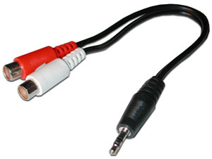

1) Stereo only though, and
2) He'd need MALE RCA inputs (or RCA M-to-M wires to connect to the above adapter like you'd normally use anyway)
3) update: as said above, may have level issues
True, but given the receiver only has the one stereo input, I suspect it will attempt to simulate surround sound.
Very true. Very early when I posted so I did miss that. The above plus a set of RCA Audio cables would do the trick.
Maybe I've just been lucky, but my HTPC used to be set up like this and I didn't have any issues.
