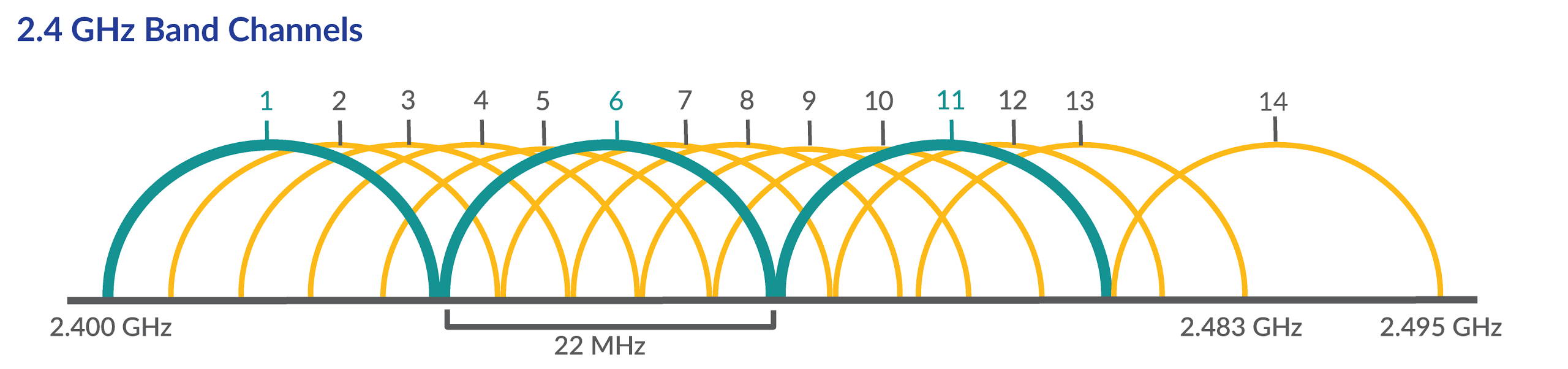

That's a loaded question. As with any frequencies on the RF band, 2.4GHz is chopped up into smaller chunks and each chunk can be further shared with multiple devices. Standards were developed so there's always order in the chaos. The most common set of rules in this context is the IEEE 802.11 protocols. This is where things like WiFi and Bluetooth coexistence mechanisms are defined, among many many others.
2.4ghz is a band, there are many channels. As long as they're operating at different channels and channel widths don't overlap. You should be fine.
