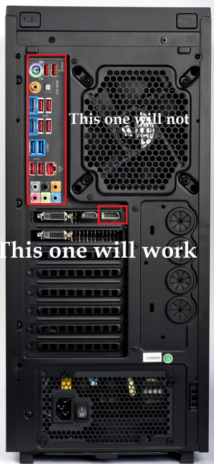

From what I have read, you are trying to connect to the onboard graphics (the higher up one) aswell as the GPU HDMI. These will not work together. What you need to do is get an adapter to convert the display port to hdmi.
[edit] here is a diagram (sorry for the bad paint skills)Link to Diargam
[edit] Also links to converters
UK: http://www.amazon.co.uk/DisplayPort-HDMI-Converter-Adapter-Male/dp/B0027HYK7S
US: http://www.amazon.com/Cable-Matters-Plated-DisplayPort-Adapter/dp/B005H3I38Q/ref=sr_1_2?ie=UTF8&qid=1420747885&sr=8-2&keywords=display+port+to+hdmi
I hope this answers your question :)
[One More Edit] VGA outputs in HD it is just an analogue signal, it will still output in 1920x1080+
Thanks for the reply (And the diagram -it did help!).
From what I can see there is no display port like the one in your image on the back of my graphics card - there is HDMI, VGA and DVI I think? Image here: http://m2.agitomedia.pl/image/700x700/0/karty-graficzne/msi-geforce-gtx-750-ti-oc-2gb-ddr5-pci-e-box.2018153.2.jpg
So I assume I cannot use the adaptor?
When I use VGA my monitor doesn't seem to be in HD, the colours aren't anywhere near correct compared to when it's hooked up with the HDMI lead and the ratio messes up even though I tried to correct it with my TV remote.
The colours will be not as good with VGA but that is irrelevant because you can convert dvi to hdmi aswell as dvi is the same as signal as hdmi.
DVI to HDMI converter:
UK - http://www.amazon.co.uk/Premium-Cable-Metre-discontinued-manufacturer-Black/dp/B000GDI6FC/ref=sr_1_1?ie=UTF8&qid=1420755057&sr=8-1&keywords=dvi+to+hdmi
US - http://www.amazon.com/AmazonBasics-HDMI-DVI-Adapter-Cable/dp/B001TH7T2U/ref=sr_1_1?ie=UTF8&qid=1420755094&sr=8-1&keywords=dvi+to+hdmi
Just hook that cable up from the dvi on your gpu to the hdmi on your display and that should solve your problem.
