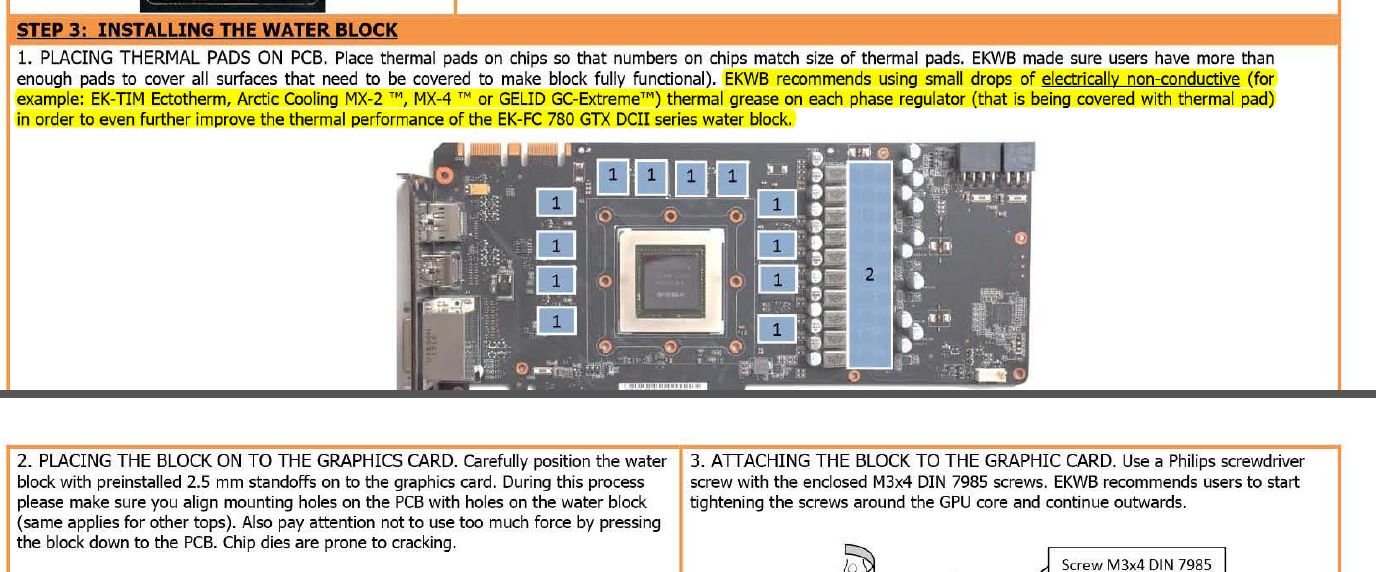

Its going to depend on what you apply it to. Just the GPU ... or according to EKs application directions ?

When you do it "per directions", you will use a whole tube per card. Work carefully but quickly as paste pliability reduces over time. Be careful on the 30 or so chips under thermal pad 2 so as not to wind up with a wad of paste between them.
A. Apply to the 30 or so chips labeled (2)
B. Apply to the 8 chips labeles (1)
C. Apply Thermal Pads
D. Apply to other side of thermal pads (1) and (2)
E. Apply to the GPU
F. Install block
G. Apply TIM to back of chips
H. Apply TIM to thermal pads
I. Apply TIM of pack of pads
J. Install backplate
To read directions "full size"
https://www.ekwb.com/shop/EK-IM/EK-IM-3831109830338.pdf
https://www.ekwb.com/shop/EK-IM/EK-IM-3831109830345.pdf
PLACING THERMAL PADS ON PCB.
Place thermal pads on chips so that numbers on chips match size of thermal pads. EKWB made sure users have more than enough pads to cover all surfaces that need to be covered to make block fully functional). EKWB recommends using small drops of
electrically non-conductive (for example: EK-TIM Ectotherm, Arctic Cooling MX-2 ™, MX-4 ™ or GELID GC-Extreme™) thermal grease on each phase regulator (that is being covered with thermal pad) in order to even further improve the thermal performance of the EK-FC980 GTX Strix series water block
