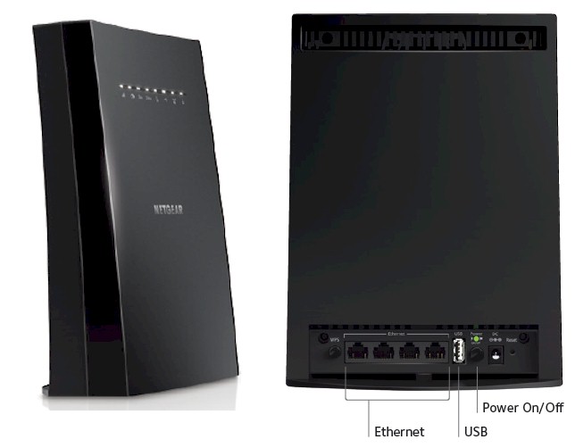

Is there a way to find out what speed my home wi-fi is running at? I have a Netgear Nighthawk AC 1750 Smart WiFi router Model R6700v2 and a Nighthawk x6s AC3000 Tri-Band WiFi Range Extender Model EX8000. My download speed from the internet is usually around 250-275Mbps but I am wondering what my network is running at in the house. I am getting pauses when streaming videos on my TV.

Found one review that's pretty extensive for EX8000
And it's spec
https://www.netgear.com/media/EX8000_DS_tcm148-77853.pdf
Same AC3000, but different 5G bandwidths to the AC3000 router, even 2.4G is a slightly different.

How is your X6S connected to your primary router? Wired or wirelessly ?
Wirelessly
I missed that there was a repeater in the path. Just using most these devices cut your throughput in at least half again because you transmitting the signal 2 times and it is all shared bandwidth. You also have a second wifi signal that can be interfered with.
I would not use a repeater unless you have no other choice. Maybe consider a powerline network adapter. If the tv has a ethernet you could place it behind the tv. They do make powerline units with wifi units in the far end. These are not real fast, most people do not get much over 100mbps even on the best ones but it is more than enough for a tv. If you have coax cable by your router and tv you can consider MoCA. MoCA is better than poweline device but it is much more costly and the tv does not need much bandwidth anyway.
