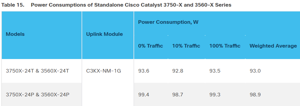

On cisco's website they post this:
This is incorrect, though. I have a 3750x-24T right here and it's using a steady 42 watts. Given that Cisco's posted number is more than double what I have right in front of me, it would seem that all their numbers are horribly overestimated. Am I missing something or are they wrong? Doesn't anyone have a 3750x 24p POE switch power idle readout? I am looking to upgrade the house but 100-150 watts is just too high, imo, to add to my already power hungry group of devices. But if it was more like 50 watts, which is seems is likely given my non poe readout, that seems more attractive. But I'd rather not find out AFTER the purchase. Does anyone know? Thank you.

Yes, this is what I did for the 24T that I have. My issue comes from the fact that I don't own every switch I am looking at buying to test. I would like to know if it's "too power hungry" BEFORE I buy the switch, not after. I am looking at the 3560x 24 and 48 poe, as well as the 3750x 24 and 48 poe. I don't own all of these to test, only the 3750x 24 T (which is not POE). I would like to know the REAL difference in power consumption so I can make an informed purchasing decision. I looked it up on cisco's site but as I said their numbers appear to be grossly inaccurate (unless I'm missing something).
There has to be someone with these switches that can supply me with the info of REAL power draw, or at least point me in the direction of an online resource that's accurate, maybe? The difference between 50 watts and 150 watts = 100 watts x 24 hours a day x 365 days a year/1000 (kw) x .12 (cents per kwh) = $105. Every year. May very well go 10 years before upgrading to 10 gig on every switchport so that's $1051 extra PER SWITCH. Given I'm already using probably a thousand watts a month (between servers, voip, APs, cams, PCs, etc) I'm trying to be a bit smarter and waste less power. Hope it helps.
