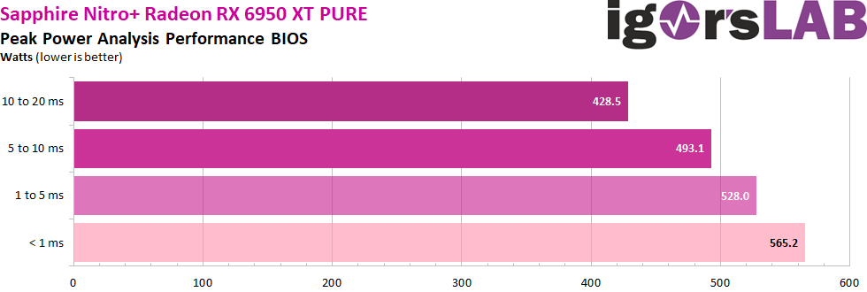

I use MS Afterburner to track my wattage. Sometimes I leave it on for the whole gaming session and I've never seen a number bigger that 220W no matter what was going on in any game. If you're implying that the GPU can suddenly peak from 220W to like 700W without Afterburner noticing it, then I see what you mean. Btw, I'm not being sarcastic. Is it really possible for the GPU to spike like that? Cuz if it is then I need a strong PSU again. If it isn't then I don't need it.

I was working recently with a guy on a 7800XT, and we saw a 400W+ spike on it. Someone else posted about a 600W spike on a 7900XTX, so it's definitely a thing, especially if you overclock. Igorslab is the best source in my opinion:
