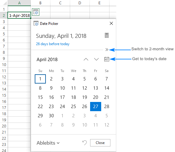

Simple. Set the cell/s to "date format" with the appropriate display format chosen. Dates will then have to be entered in that format (no getting around it). You can then do date math in any other cell/s (just make sure to set those cells to "date" to get a proper display)
You can also use the date picker for a more point-shoot entry.
THAT may be the plan!
Can the dropdown calandar be activated and navigated to the desired date
by using just the cursor keys ?
