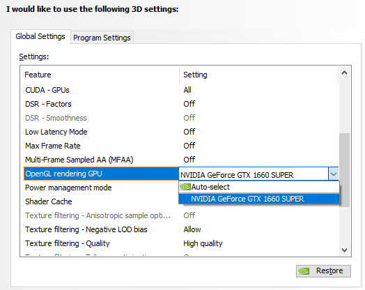

Hey! So i want to do a little testing to see how the integrated graphics work, i have a geforce 1660 super and the cpu/apu is a ryzen 5 4600g, however, there is no option in nvidia control panel to switch the 1660 super. How can i fix this? It does not appear anywhere, thanks for helping.
https://prnt.sc/1ltfbzn
You need to connect the monitor cable to your motherboard's output and not to the GPU's outputs. It should auto detect the on board graphics and install drivers if not installed already.
The cable needs to be changed outputs while the system is powered off.
Easy way, will work 100% : unplug the GeForce.
Hard way, will probably not work well / properly / at all : go to the BIOS and force-enable the iGPU, set it as primary / first enabled GPU then switch your screen's cable to the motherboard's connector.
