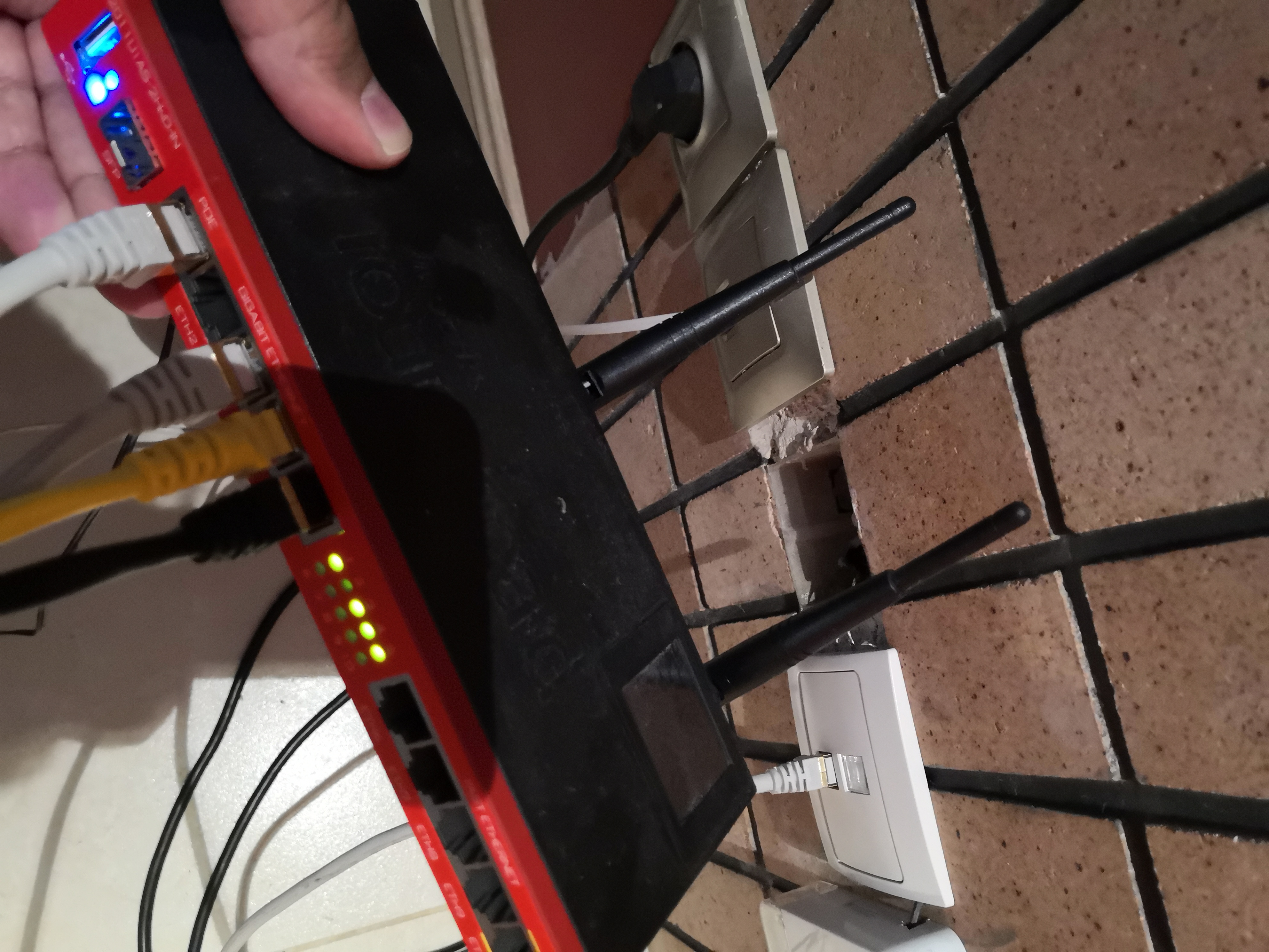

This is my upload speed :
it's capped at 100 for some weird reason i don't know if it's the ONT i'm using or my fibers ? i don't know
This is my ONT. some old taiwanese brand from the year 2011 . they only use it here and in china .
This is the access point i use to get that speed.
A mikrotik RnD something
And this is a CAT 7 CAT 6 wall socket i installed yesterday by myself , to distribute the internet throughout the house and to my parents.
What's the exact model number of the ONT and router? Do either of those have 100mbps ports??
bniknafs9
Jan 21, 2019
648
65
10,190
ONT is Zyxel , pmg5317-t20b , with custom firmware added by myself .
it's old zyxel they don't use in taiwan itself . only in china and here.
router is
RB2011UiAS-2HnD-IN
the ONT has four gigabit/2.5 g ? ports
the router has 5 gigabit ports and 5
100mbps ports
but i'm not using any of those 100mbps ports ... so to say
