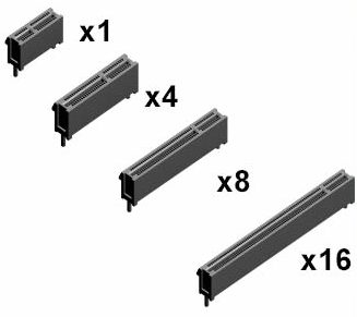

anyways, so to say for every m.2 drive added to an expansion pcie card one would require x4 times that of x16 pcie? ( is that the requirement, guess, right now we know)
x4 and x16 is PCIE slot width (lane count).
PCIE slot can be x16 physically and with only x4 electrical connectivity. That's the second PCIE x16 slot on your motherboard.
I've read that my primary pcie slot would start running at 8x instead of 16x, what would this mean for my graphics performance?
That depends on motherboard. You have to read motherboard specification.
If it is about Gigabyte B460M D3H , then second PCIE x16 (x4) slot runs in x4 mode and using it doesn't impact the first PCIE x16 slot.
You can use M.2 PCIE adapter with single M.2 NVME card in second PCIE x16 (x4) slot.
There exist M.2 PCIE adapters with multiple M.2 slots on it. Those adapters require either x8 or full x16 connectivity. Will not work in your x4 slot.
