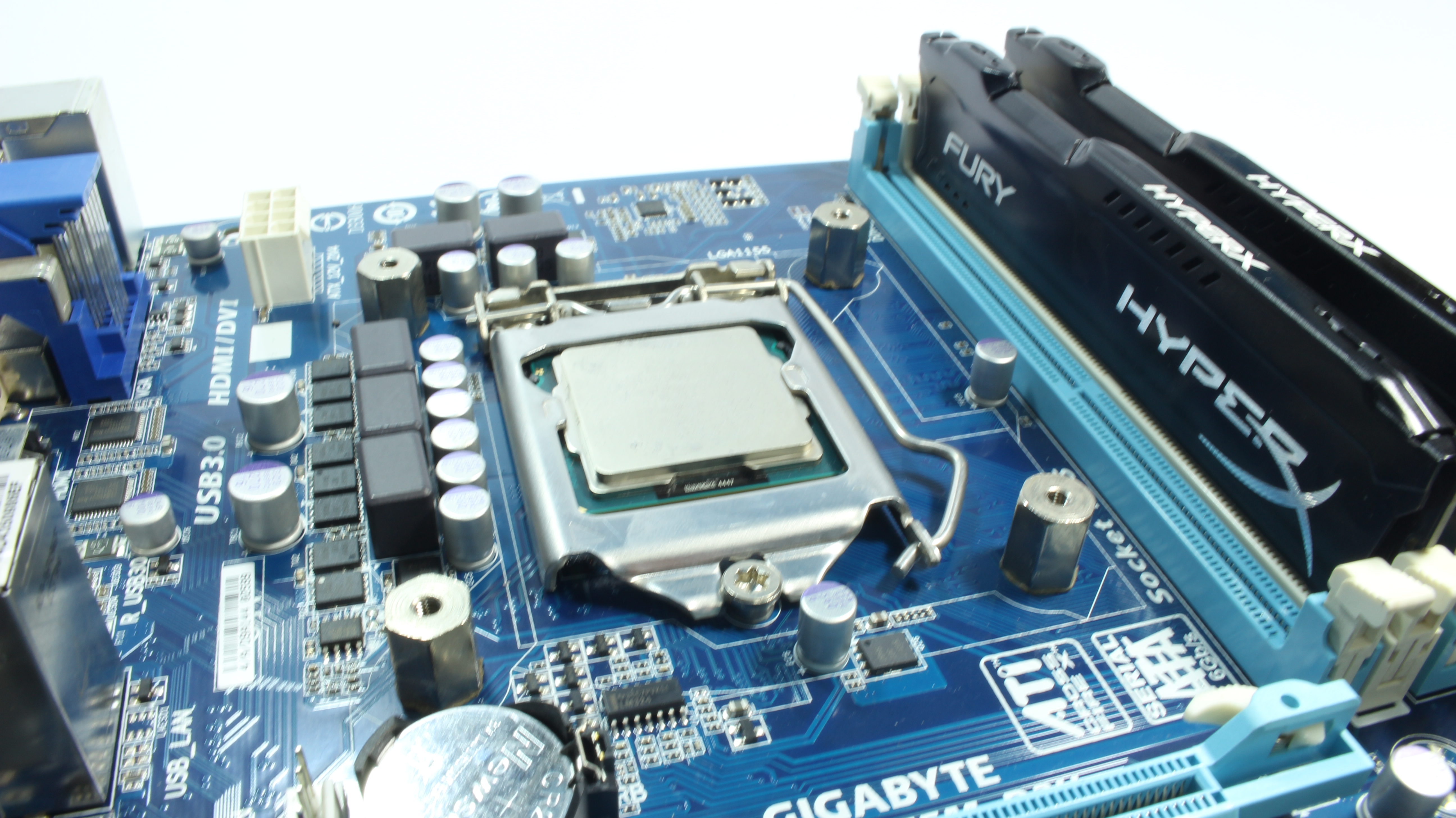

Never mind, I had enough and just bought a GIGABYTE GA-Z68X-UD3-B3, LGA 1155/Socket H2, Intel board from ebay in working condition.
It was likely since the I5 was a second gen I5 2500K, the cheap motherboard they use in pre built system such as HP produce to keep costs down for themselves while charging for it over priced as a complete system build.
The board was not capable of even overclocking the I5 2500K cpu anyway Skynetrising.
Since I got the I5 2500K cpu as a give away I cannot complain really can I.
And it`s a decent motherboard the GIGABYTE GA-Z68X-UD3-B3, LGA 1155/Socket H2, Intel Motherboard isn`t it ?
