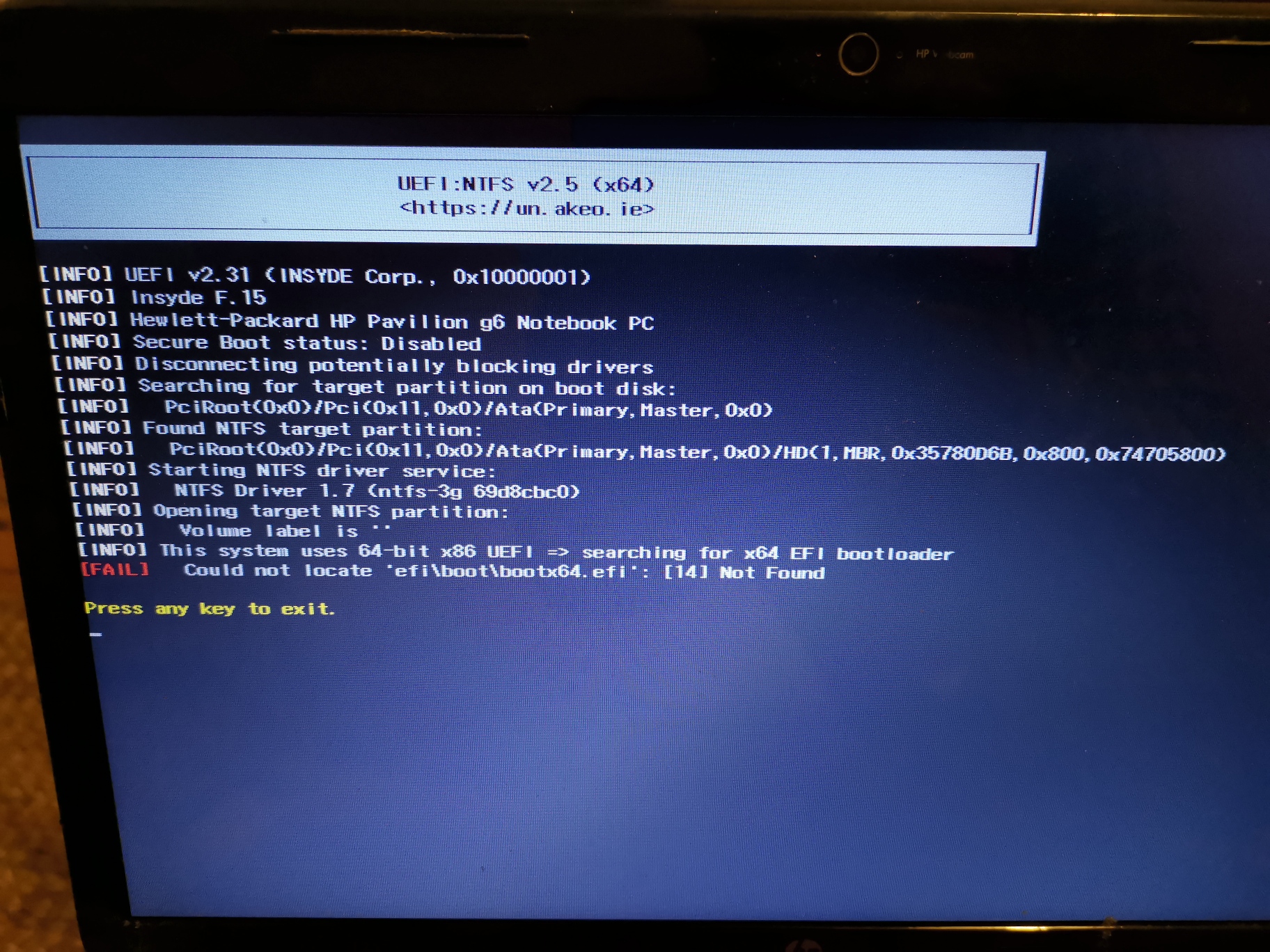

Hi Lutfij, thanks for your reply. I've installed a freshly formatted 1tb ssd in the laptop and again tried to install windows but i'm still having problems. Once i select the bootable usb I get this screen,
This screen hangs for around 10 minutes and I then get this message,
Once I press any key it goes back to the first screen. Do you know what this means or what could be causing it?

Your posted screenshot tells you exactly what the problem is. It cannot find the efi\boot\bootx64.efi file on the boot partition. You will either have to use an install/restore image downloaded from HP (for that specific model) or a retail copy of Windows to perform the installation.
