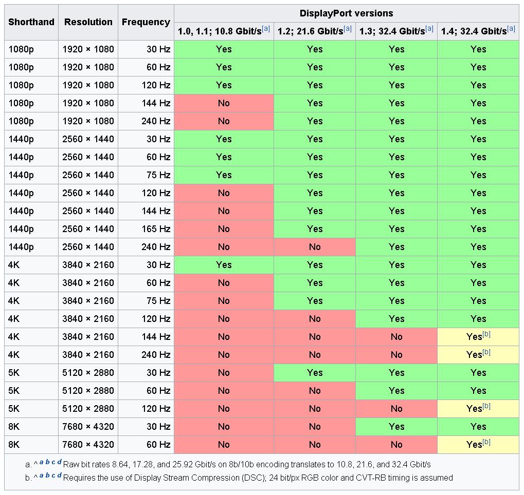

Look at Display Port version for the cable. Sellers don't always know, what they're writing.
Display Port 1.2 supports 1080p up to 240Hz.
DP cable supporting 1080p up to 120Hz would be DP 1.0 or 1.1 version.
https://www.evga.com/support/faq/FAQdetails.aspx?faqid=59677
