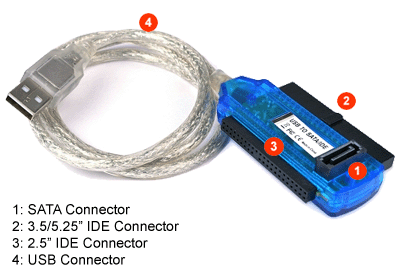

You can purchase a USB-to-IDE/SATA 'kit' that will let you plug the USB connector into your laptop, and then plug the HDD into the other port (IDE or SATA...

You can purchase a USB-to-IDE/SATA 'kit' that will let you plug the USB connector into your laptop, and then plug the HDD into the other port (IDE or SATA, depending on age of your external drive). If the drive is good, it will power up and your notebook can view it like that.
Computer retailers might have this kit, and on-line places will, usually in the $15-35 range - USB 3.0 connectors will be more expensive and will have faster data-transfers, but USB 2's will be effective as well.
