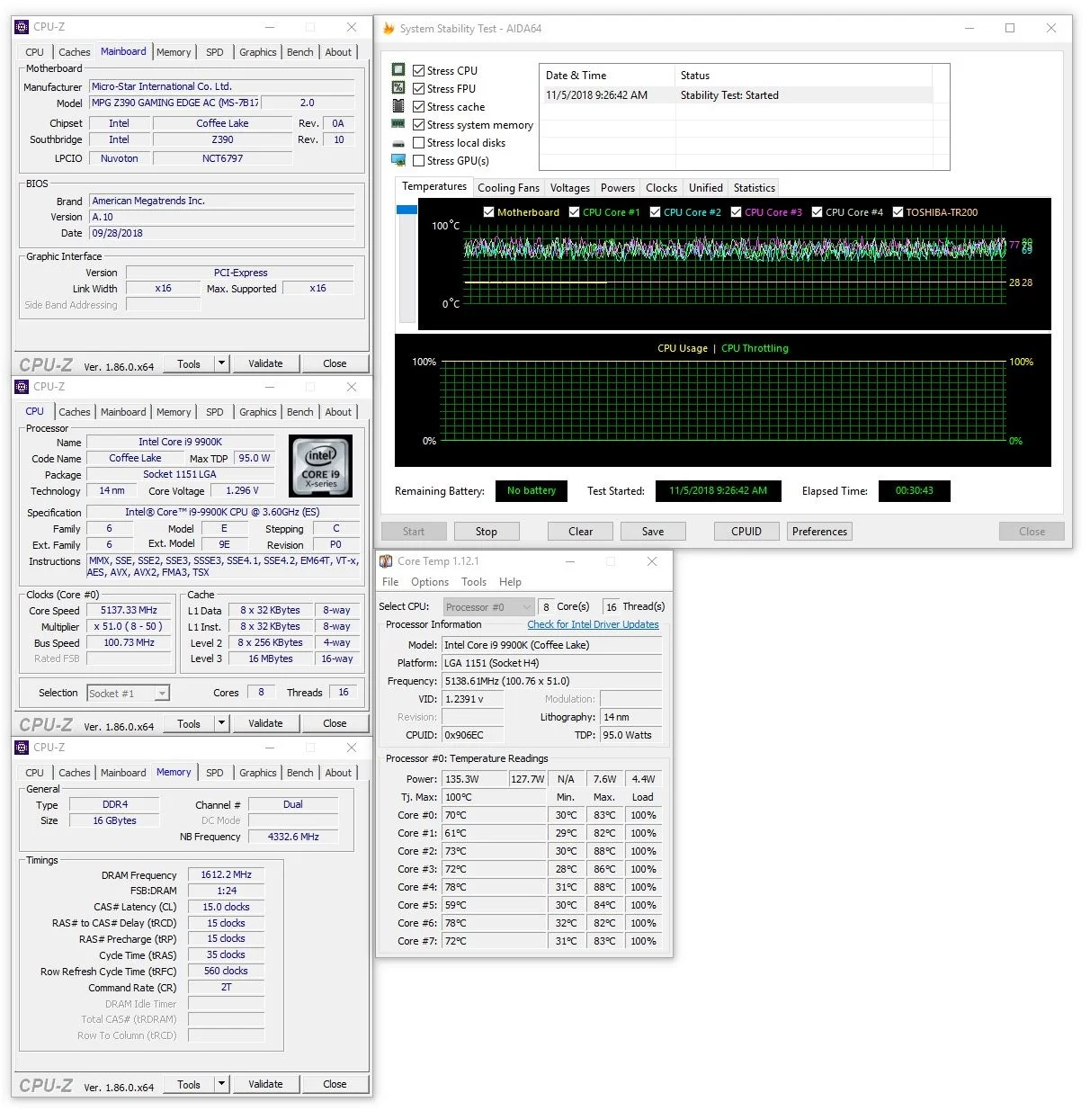

source Intel Core i9-9900K @ 5.3 GHz With 1.365V (100 x 53) The Intel Core i9-9900K when overclocked, breaches the 400W barrier.

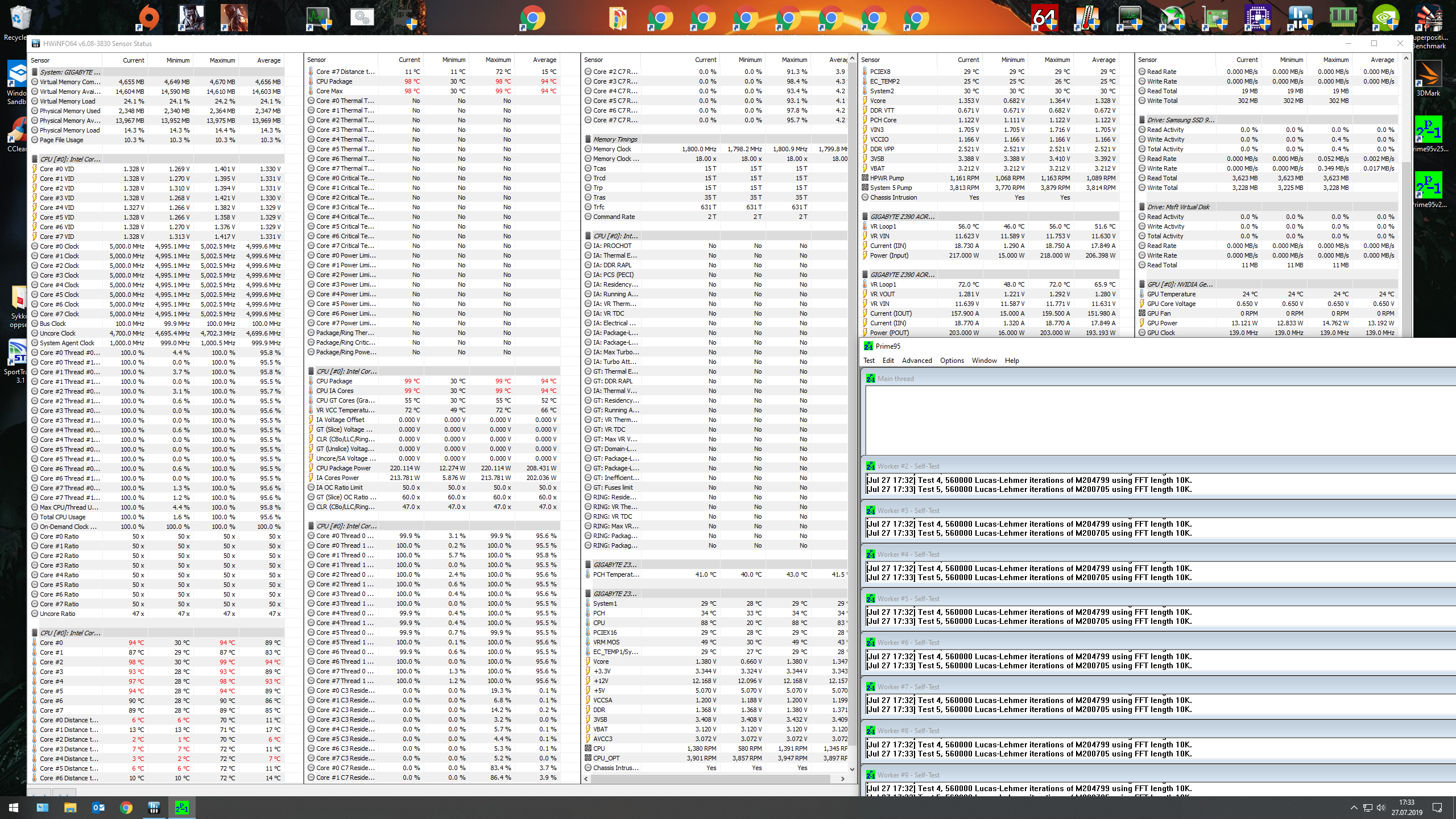

well after doing some prime 95 testing i have it down to 4.7ghz as 5 was not stable right off the start of the torture test. So far its not crashing on me only 2 hours into the test tho. 4,9ghz and 4.8 was stable off the start of the test but temps were up to 99-100 degress after like 15 mins but 4.7 is giving me 75-79 degress right now. I do have a custom water loop in my build, but for psu i will be buying a new one here soon.

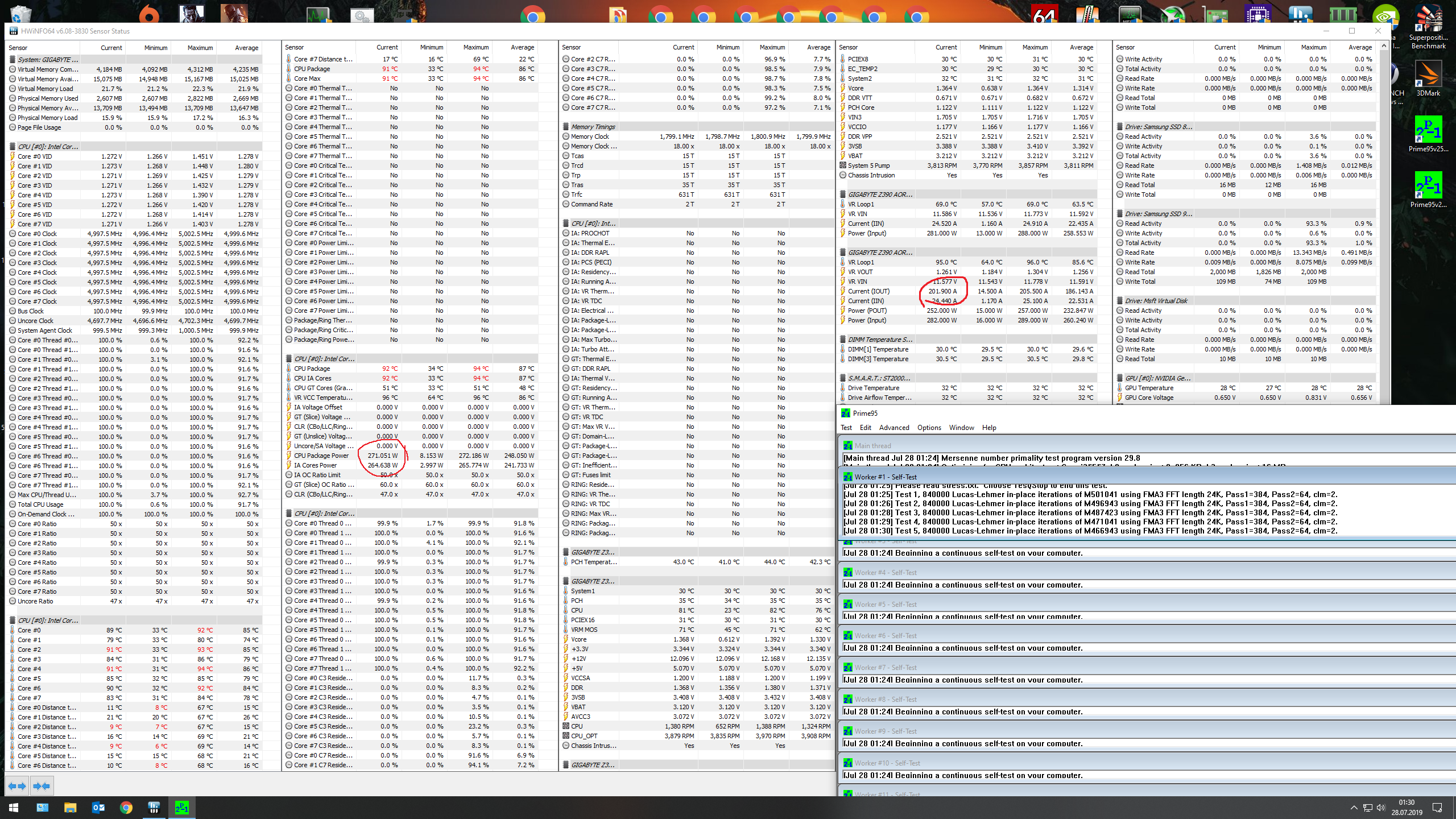

Thank you that makes sense, im hitting max 80 degrees with prime95 running still so i should be good with the cooling in my system as it hasnt gotten any hotter and seems to be stable, i believe 4.7ghz at 1.2 volts is working good. Thank you for the information
80°C while Running Prime95 Small FFT, (which is the ONLY thing you should be running to test for thermals using Prime95 is "Small FFT" (Not "smallest fft", not blend, not large FFT), and you should be running it with AVX and AVX 2 disabled UNLESS you know you run games or applications that make HEAVY use of AVX, and then you should leave them enabled but use an offset in the BIOS), is fine. It is the very last "edge" of "fine", but it IS fine. If you are at 80°C while running Prime95 Small FFT then you are never going to see any game or application cause out of spec thermal conditions unless they use AVX instructions or something causes a change in your cooling performance.

PSU will get the job done, its not an issue. Here system load 360-400 watts https://wccftech.com/review/intel-core-i9-9900k-8-core-cpu-z390-aorus-master-review/9/ and add gpu.
With Prime 95 small fft's getting extreme temps is to be expected. Going right up to the edge is expected temp wise. In games you will be much lower. Worry if you do a lot of HEVC etc. You should run Aida64 for stress testing, like Darkbreeze states prime95 small fft's are great for people that need to test the cooling for heavy loads over a long deration of time. This is needed if you have to be stable, say you are running folding@home etc.
From the temps you state I would guess you have a version of prime95 with avx enabled. Sounds like 4.9Ghz is doable and 5GHz will take some work. If your PC is just for games you should be fine. Monitor your VRM's as well. Setting the VRM frequency to 500KHz can help too, default is normally 300KHz. The faster respoind helps keep things stable.
Basically HEVC is the same AVX load as Prime95 small fft's. Some HEVC loads hit my CPU like a hammer.
This image shows the cooling issue of prime 95 compared to aida64. Prime95 is 322 watts and Aida64 is 275.
source
So test in aida64, it tests all the instructions. Prime95 just tests AVX and pulls maximum power. This is how your testing should look.
Remember unlike AMD you can set an AVX offset to help with cooling if needed. You should go for 5GHz with an AVX offset. Start with 4.9GHz offset -1. You should be able to limit power draw as well.
yes only running prime95 and small fft with avx disabled and only gettting 80 max at 4.7ghz 1.25 volts, so when i was running it for 15mins at 4.8 and 4.9 and getting 100 degrees max is normal then?

Normal before delidding @ 5GHz 1.3 volts. Temps hit 99c on the cpu, Prime95 small fft's.
10k_temps_before-png.127894
Buildzoid I believe said that anything above 150Amps on the 9900k is uncoolable unless you delid. Here's an image of 200 Amps delidded (cpu 5GHz 271 watts):
this_will_keep_me_warm-png.127911
source
Note after delidding temps are fine in Prime95 small fft's @5GHz (they are in the low 90c's, maximum 94c). Note the power the cpu is pulling is 271 watts and the motherboard VRM are at 201 Amps @ 95c.
Really? Do you have some insider information that magically tells you exactly WHAT 750w power supply they have, or are you just assuming that because it's "750w" then it must be sufficient? This kind of blanket statement often ends up doing a lot of ass biting later. Not to bash your response, but that particular one wasn't particularly recommendable unless there's something I'm missing and I don't think there is. If the OP has determined they need to replace the PSU then it's probably because they've determined that what they have has quality issues, not capacity issues.
These are the temps @ 150 Amps delidded. See that even in Prime95 small fft's you can get under 90c with a 5GHz 9900k
Running at >85°C consistently, on a regular basis, even intermittently for long periods of time, is probably not the greatest idea. If you have to do that, then you would be wise to reduce something somewhere. Electromigration and VT shift are going to start having a long term effect on transistor performance.
So if that's how you need to NOT get there, then that's great, but keep in mind that if you don't REALLY know what you are doing, delidding can mean INSTANT death to your CPU, no medium to long term usage required. LOL.

The 9900k runs that hot in prime95 small fft's. There is no way to avoid it because of the power draw at higher frequencies like 5GHz. Delidding and going direct die yelds lower temps in games and prime95. At a certain point, to be able to cool the 9900k you have no choice.
Image 1: Got a Corsair H115i AIO 280mm, OC'ed 9900k @5GHz. Great is it stable? Run aida64, first stop 100c on every core.
You're right about delidding, failure can damage the cpu beyond repair (you don't have to do something wrong, crap happens). Good luck RMA'ing that CPU.
The 9900k will run at higher temps like >85c all day long. The issue is that at higher frequencies you will go >90c and start hitting 100c. Hitting TJUNCTION 100°C is the point the cpu will start thermal throttling.
To fix it, you either have to limit the power draw of the cpu, reduce the frequency (AVX offset that keeps the CPU at 4.7-4.8GHz), reduce the vcore or take action to improve cooling. A chiller (expensive) is one example of pushing the limits cooling wise. Some people buy the MORA3 Radiator https://thermalbench.com/2016/09/12/watercool-heatkiller-mo-ra3-420-pro-radiator/2/.
