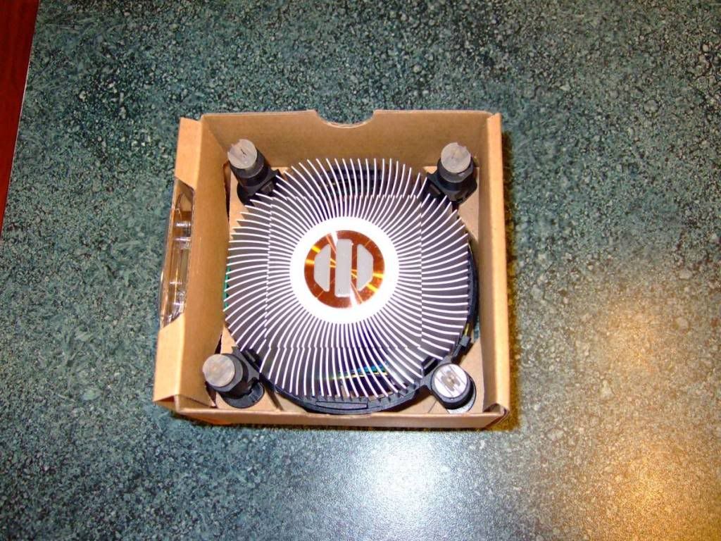

I'm building my first computer, and purchased the Intel i5-2500 CPU, and it comes with the cooling compound already "installed"
http://i1108.photobucket.com/albums/h412/ukiah5060/DSCF2841.jpg
so to speak, but a friend of mine that has built many computers is adamant about putting another tiny glob(about the size of a small pea) on before I install the heatsink/fan. I asked hey why, thinking that Intel must know how much is needed. She says she never trusts the amount that is used. I've never built a computer, and she has built many, but it still kind of defies logic that a company like Intel would put the compound on, and not put a sufficient amount, but I simply don't know. I don't totally doubt she's right, but I'm curious what others think. Thanks in advance!
Intel provides enough thermal paste on their heatsinks. If you do not want to use the pre-applied thermal paste, then it's best wipe it off with at least 90% alcohol, then apply a fresh coat (pea / rice size) of thermal paste. I recommend Arctic Silver 5 which you can probably buy at your local BestBuy.
Mixing thermal paste is generally not recommended because the properties of both can interfere with one another. Your temps will not be crazy high or anything like that, but your temps may not be as low as they could be.

So, if I'm following you correctly, nothing at all wrong with the pre applied paste Intel puts on, yes? I have no reason that I know of to remove their paste and use something else, unless that is common practice and recommended.
And the second part of your reply, where you said my temps might not be as low as they could be....were you referring to what might happen if I mix pastes, or if I use the pre installed paste? Just want to make sure I understood that correctly. :)
both--if you mix pastes or use the intel pre-installed paste then your temps may be a little higher than just
using a high quality paste
not by a huge amount --and if not heavily overclocking then it wouldnt really be significant enough to bother
about
kind of like petrol in your car i suppose--normal petrol works fine but a higher octane petrol gives a bit more
performance--so its not strictly necessary to use other than the stock paste but if you want the maximum
cooling performance then you use a more expensive paste

Aside from the problems of mixing paste, and the fact that Intel's paste is fine, adding additional paste is just not a good idea. The paste's only job is to fill in the tiny imperfections in the metal and provide better contact. Too much paste acts as a buffer and actually hinders proper heat transfer.
Adding more paste to what is already the right amount of paste is never good.
