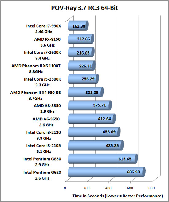

Keep in mind: The chart is strictly concerned with CPUs from a gaming perspective.
If the processor is fast enough to keep your system from being bottlenecked, then gaming performance is more readily affected by the graphics card(s) than by the CPU.
Also keep in mind that any framerate over 60 is a waste on a monitor that has a 60 Hz refresh rate. If your system is able to keep your game running at 60 fps minimum, especially in lagged situations, than anything over that is gravy.

amd cpus from what ive seen do the job but no where near aswell as intel cpus. intel is just better overall in most cases,for a web surfing pc and all id say go with amd but if your gaming id go with something like a i5 2500k alot of potential there. amds bulldozer from the bench marks i seen doesnt match up to the i5 2500k at stock clock..this is a 8 core vs 4 core
esrever
Splendid
not really. The 6 core thubans gives near i7 performance for a lot cheaper in rendering, bulldozer actually does better than the i7 2600k.

amd may have higher benchmarks on some stuff but overall the 2500k decimates the fx 8150 and its cheaper off newegg,at least from every gameplay video ive seen of it. bulldozers got the power but no game or phot edidting that i know of can take advantage of 8 cores
noob2222
Nov 19, 2007
2,722
20,860
40
might want to check the review here before saying that
Last I checked, photoshop was for photo editing.
