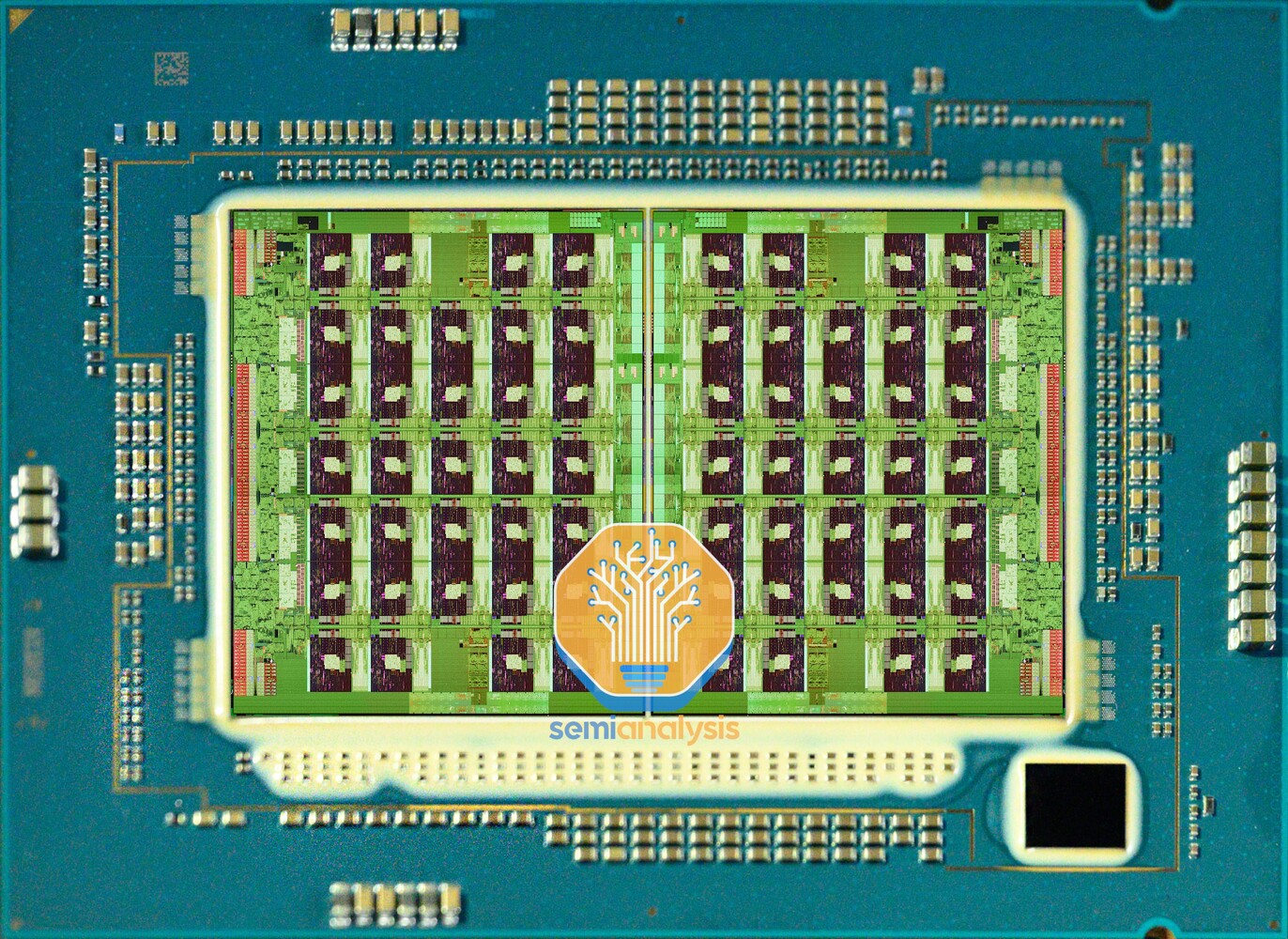

It's a pretty safe bet that EMR will clock higher than SPR given that it uses refreshed cores and the XCC CPUs are two tiles instead of four. Hopefully we'll get full core details on December 14th when the launch is supposed to be.

Regarding the number of tiles, are you aware of analysis of the scaling from the single-tile to the quad-tile version of SPR?

I know all the split controllers and the required 10 EMIB connections were a big manufacturing problem. I'm not sure there will be a performance advantage (beyond the obvious clocks/DRAM bandwidth) to the two tiles vs four, but there will be a notable improvement to the manufacturing side (mostly packaging).

@thestryker According to Semianalysis, he's hinting that the new configuration is indeed to aim for better performance. That's why they went to a bigger two-Tile setup despite costing even more to manufacture than the four Tile SPR.
While some applications will only benefit from other aspects, many other server applications will benefit from the low-level changes the changed config brings.

Cache varies by SKU, but the top end EMR has much more L3 cache than anything on SPR (6.25MB/core vs 2.625MB/core).
The wafer cost is higher, but packaging cost is much lower.
Relatively speaking, but if it costs Intel that much more to put 4 tiles per package than 2, it seems like they haven't mastered Foveros quite like they've been portraying.

10x EMIB on Sapphire Rapids
Sapphire Rapids is going to be using four tiles connected with 10 EMIB connections using a 55-micron connection pitch. Normally you might think that a 2x2 array of tiles would need equal EMIBs per tile-to-tile connection, so in this case with 2 EMIBs per connection, that would be eight – why is Intel quoting 10 here? That comes down to the way Sapphire Rapids is designed.
Because Intel wants SPR to look monolithic to every operating system, Intel has essentially cut its inter-core mesh horizontally and vertically. That way each connection through the EMIB is seen purely as the next step on the mesh. But Intel’s monolithic designs are not symmetric in either of those dimensions – usually features like the PCIe or QPI are on the edges, and not in the same place in every corner. Intel has told us that in Sapphire Rapids, this is similarly the case, and one dimension is using 3 EMIBs per connection while the other dimension is using 2 EMIBs per connection.

Why is connection-count the dominant cost factor, rather than the actual number contact balls/pads or the number of chiplets?
There hasn't been enough information put out publicly (probably because TSMC hasn't fielded their version yet), but from what has the predominant problematic part is that the EMIB bridge has to be embedded in the substrate. There's some failure percentage when you connect the chips to the bridge as well and while it is likely extremely small the failure rate is multiplied with number of connections.
You're also absolutely right about number of chiplets tiles (edit: I should use Intel terminology here) and contacts having a part to play in packaging costs as well and in theory these costs should be lower.
