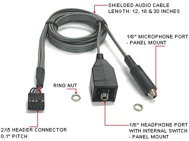

Like Paperdoc said, you'd loose your front mic/headphone ports, if you want to use the internal HD Audio header. But it can be used as well, whereby you need an adapter, this or similar:
Specs: https://www.frontx.com/pro/p110_030.html
After which, look for a 3.5mm jack speaker, that is powered by the 3.5mm jack. E.g this thing (or similar),
amazon: https://www.amazon.com/Zopsc-Speaker-Portable-Exquisite-Appearance/dp/B07QL47V48
