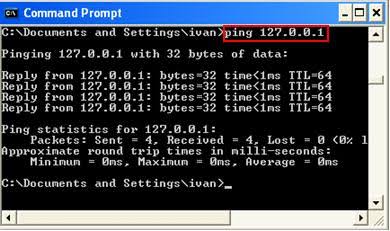

I bought new router. Plugged main Internet cable into my router. Connected router and PC with another cable. I can access Internet with my phone through WiFi. But my PC still not able to access Internet. I'm a noob when it comes to computers. Few of my friends told me that there could be problem with my LAN card. So i ping 127.0.0.1
Result is similar to what shown in image.

Ping 127.0.0.1 is basically a special test for testing your own computer. 127.0.0.1 is also referred to as "localhost".
