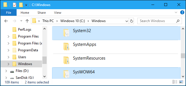

WOW64 is thex86 emulator that allows 32-bit Windows-based applications to run on 64-bit Windows but x86 applications are re-directed to the x86 \syswow64 when seeking the x64 \system32. The C:\Windows\System32 folder still exists in the 64-bit version of Windows but it is used as a repository for 64-bit .dll files.
SysWOW64 equates to "Windows 32-bit on Windows 64-bit". This folder contains all the 32-bit .dll files required for compatibility which run on top of the 64-bit version of Windows.
https://answers.microsoft.com/en-us/windows/forum/all/syswow64/f09e9cf7-1f9d-44b8-b71b-c2fc61479307
Despite the names, System32 is full of 64-bit files and SysWOW64 is full of 32-bit files.
the naming scheme is actually the result of a lot of drivers hard coding system32 as driver location, even in 64bit drivers. Easier to change how windows reacts to them than break a bunch of programs.
So to answer ops question, yes its normal. Anyone on 64bit windows will have it in both places.
