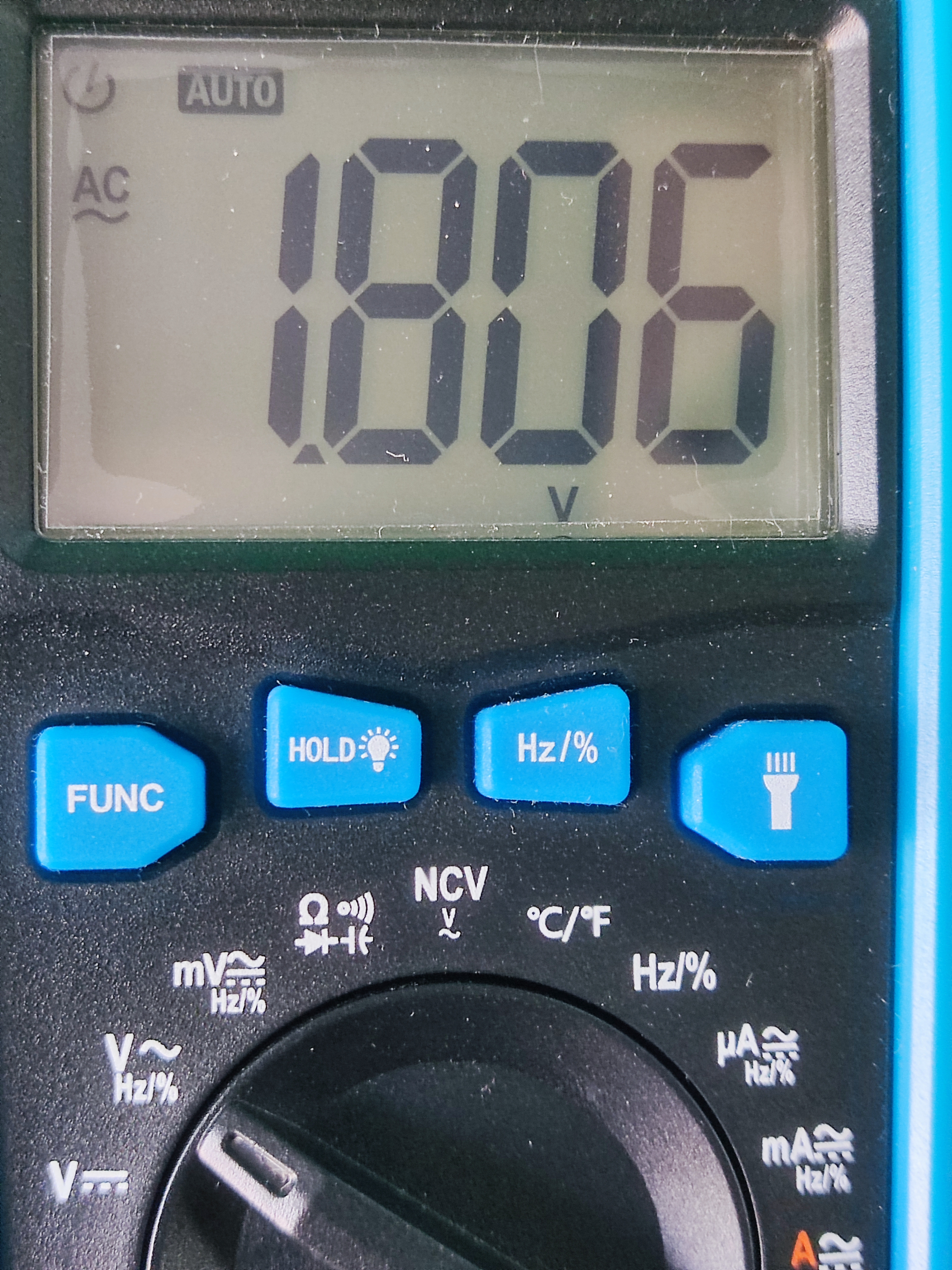

After one of my friend said that his PC was giving him shocks I checked that he didn't have a proper cable. After installing a 3pin cable with ground pin I came back and checked my system. Everything was fine and no shocks but there is a slight voltage (~1.8VAC) on the USB port metal part or bare metal parts of the PC when checked with a multimeter.
Is this a cause of concern?
My Mains Power
Live-Neutral is at ~243VAC
Live-Ground is at ~244VAC
Neutral-Ground is at ~0.65VAC
My Mains Power
Yes of course but in this case it's not h full AC but half of square wave with side band.
