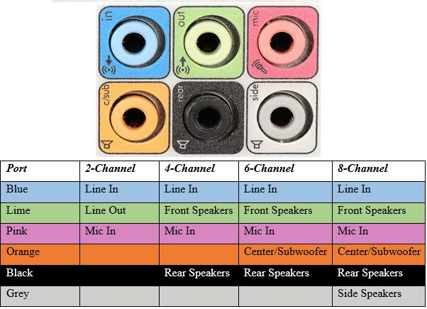

Is it possible?
Depends.
For one, you can not get 5.1, since that is 6 speaker setup, with subwoofer. Best what you have, are 2 speakers with 4 speaker drives.
If your speakers are 3.5mm jack, you could plug one into line-out (green) for front left/right and another speaker into black port, for back left/right.
Image:
Afterwards, it's just configuring the speakers within OS, for 4-channel audio.

so can I combine these two speakers to make them like 5.1 speakers?
No.
Like i said above (and you can reference to my image as well), best you can get, is 4-channel setup, since 5.1 setup is 6 different speakers. But what you have, are only 2 speakers.

Your 2.1 + 2 doesn't equal to 5.1. At best, it equals to 4.1 since you do not have a center speaker.

My motherboard doesn't have the orange,black and grey jack port, do i need dedicated sound card for that?
In this case, yes. Since you'd need dedicated audio channels for rear speakers and for center/subwoofer as well.
So is it possible if i add another speaker?
But, how do i setting the speaker to be rear left right, center etc?.
With your current setup, and with only Line-Out, best you could get, in terms of surround, is mirroring the front left/right to the back left/right. Either via the dedicated AMP, that does it. Or via 3.5mm Y-splitter.
