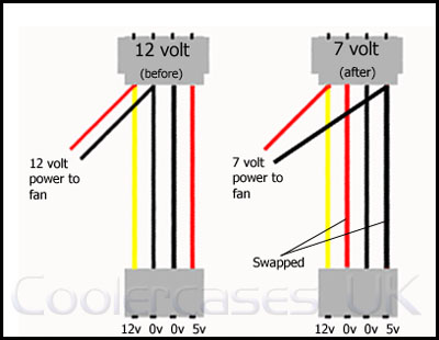

The best way to test the cable is to use an ATX power tester, it will test both 12V and 5V pins.
If you don't have the tester, you can use a cooling fan to test the Molex connector, the fan should spin at full speed on 12V and much slower on 5V.
