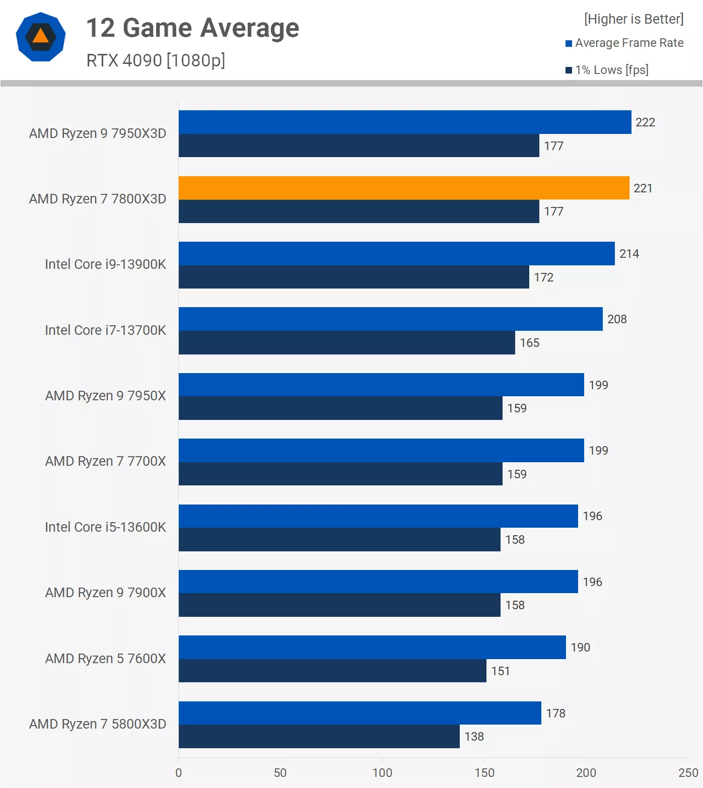

Just look at the gaming performance of the R7-5800X3D, even compared to the (much faster) R7-7800X3D (Credit to Techspot):
Now, it sure looks like the R7-7800X3D is much faster than the R7-5800X3D and it is. However, you have to take a couple of things into account. Firstly, you're never going to notice the difference in a game between 178FPS and 221FPS. They're both going to be perfect and they're going to be perfect for years to come because they both more than max-out 144Hz monitors. If you don't even have a 144Hz monitor but a 60Hz like most people, it will take even longer before you can tell the difference.
