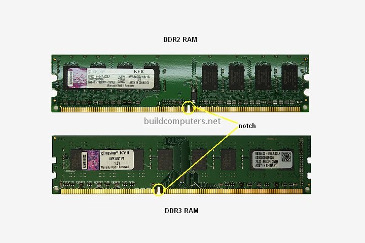

Does your motherboard support ddr3 memory? IF you have ddr2 memory, you can only upgrade to more ddr2, ddr3 is out of the question on the same motherboard.

There are very few motherboard that support ddr2 and ddr3(and none that support them at the same time). They were all retail boards(had 2 slots for ddr2 and 2 for ddr3). I have never seen or heard of an OEM board that did this, but that doesn't man one doesn't exist. We would need the make and model of the system or the board to know for sure, but most likely your board does not support ddr3. Adding another 2Gb stick of ddr2 may help.

Trying to upgrade your computer's ram to DDR3 would be a waste of funds as it would require purchasing a new motherboard and with that potentially a new processor. When you upgrade a desktop computer, if you want to upgrade ram from DDR2 to DDR3, the motherboard and processor come with it. The motherboard and processor are two pieces literally built for one another. With that the motherboard has certain standards of slots that are built in. RAM's DDR, PCI's express, USB's, and SATA's slot versions are the things to look at as they are what are upgraded to keep to the latest standard. But I assume you want to keep the rest of the machine intact and keep costs as low as possible. So forget trying to upgrade everything else unless you want to purchase a whole new machine.
Thank you all for your advice, especially for the DDR3 isn't compatible with MB warning :$. The slots are 2x 1GB, and the MB only has 2 slots. The motherboard itself is a foxconn MB (never heard of it actually). I will look online for 2x 2GB DDR2, but if I'm correct those are far more expensive compared to DDR3 as they aren't being made anymore?
