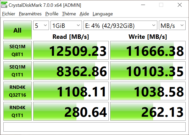

As a contrast, modern high speed Gen5 M.2 NVMe drives are much faster than SATA SSDs. See below.
crystaldisk-mark-nvme-png.148146
