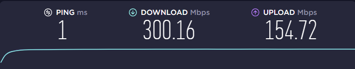

I have 300MB connection and didn't noticed any limitation until today after I formatted my PC and reinstalled Windows 10, the speed was capped at 100MB afterwards (downloading at 11MB/s maximum). I thought it could be something related to drivers so I formatted again and manually installed the LAN Driver, problem persisted. Tried variety of things and nothing worked, the problem was with my PC or the cable since the connection over wi-fi was okay.
After some more troubleshooting I found this solution that worked, going to Ethernet Status at Control Painel, my Speed was set to 100Mbps, in the Advanced tab I changed the Speed & Duplex from Auto Negotiation to 1.0Gbps/Full Duplex, after this I reconnected the cable and my speed is fixed, downloaded a big file with the same constant speed that I had before (~35MB/s).

UPDATE! FIXED!
I decided to put at Auto to see what happens and for my happy surprise the speed stayed at 1.0Gbps, letting my internet to reach the full 300MB that I pay for.
