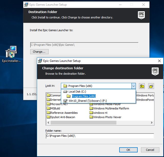

My plan: Install the launcher to a new drive. Remove the drive. Try to remove the uninstall entry with CCleaner to see what happens.

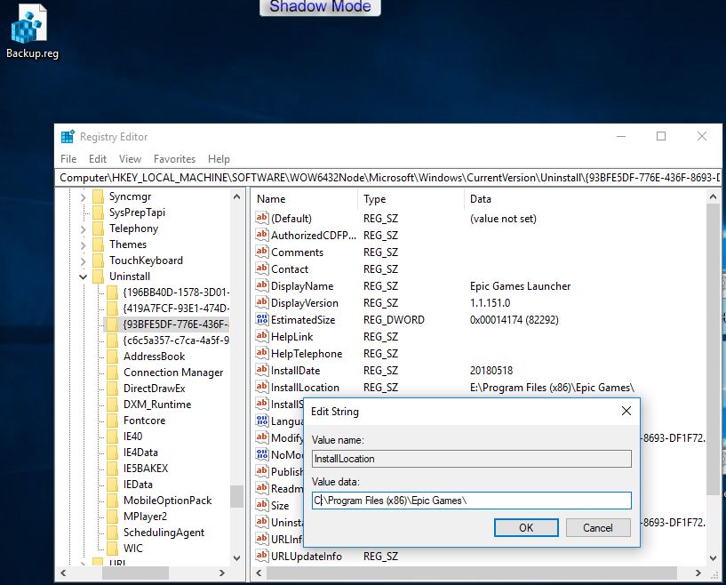

* Run regedit, near the top, paste the following line in and press enter: Computer\HKEY_LOCAL_MACHINE\SOFTWARE\WOW6432Node\Microsoft\Windows\CurrentVersion\Uninstall\{93BFE5DF-776E-436F-8693-DF1F72C0E3C1}
* On the left, right click on Uninstall and choose Export. Save it as Backup.reg. If something goes wrong, double click on the Backup.reg to restore it back to how it was.
* Go back to {93BFE5DF-776E-436F-8693-DF1F72C0E3C1} below.
* On the right, change the InstallLocation to path you want to use. Example: C:\Program Files (x86)\Epic Games\

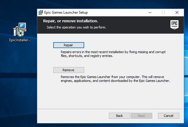

* Run the installer (and hopefully you'll see 2 different options) and choose to Remove. This allows the registry to be reset.

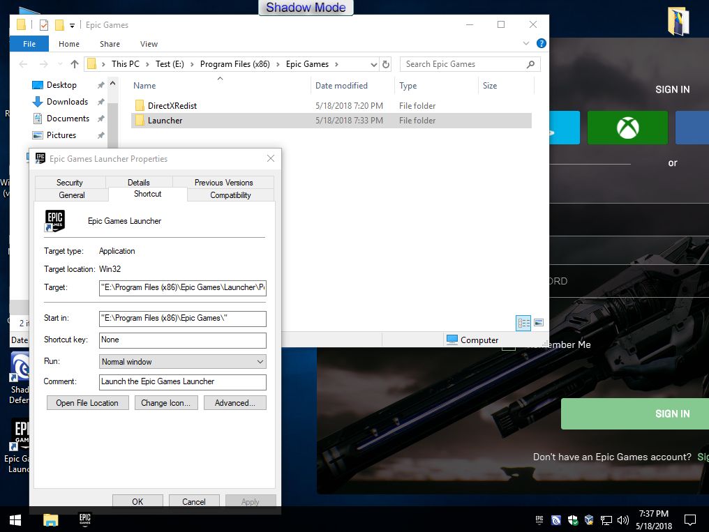

Installed on Drive E.

Editing Registry.
Run installer and choose Remove.
