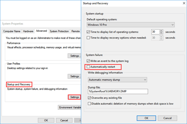

Turn off automatic reboot after system failue. You should get BSOD with info about, what caused it.

I've already turned off automatic reboot as and when it crashes it doesn't give a BSOD, simply all powers down.

It would power down and reboot until I turned the option off. Now it requires the PSU to be completely turned off and on again before it can be rebooted up.
