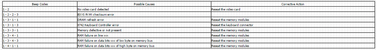

If you could send me a model number so I can find some documents for diagnosing the beep it sounds like a possible cpu power error but I cannot be sure. Do any of the power/battery/drive activity lights come on when you switch it on if so which ones?

the solution to 1 beep is "replace the mother board" i cant replace the motherboard on a laptop
If it is one beep then pause then beep etc it is a motherboard error. If it plays a sequence of timed beeps it is something else. It would be possible to get the motherboard replaced by dell but I'm assuming your warranty is up so it could be pricey.
