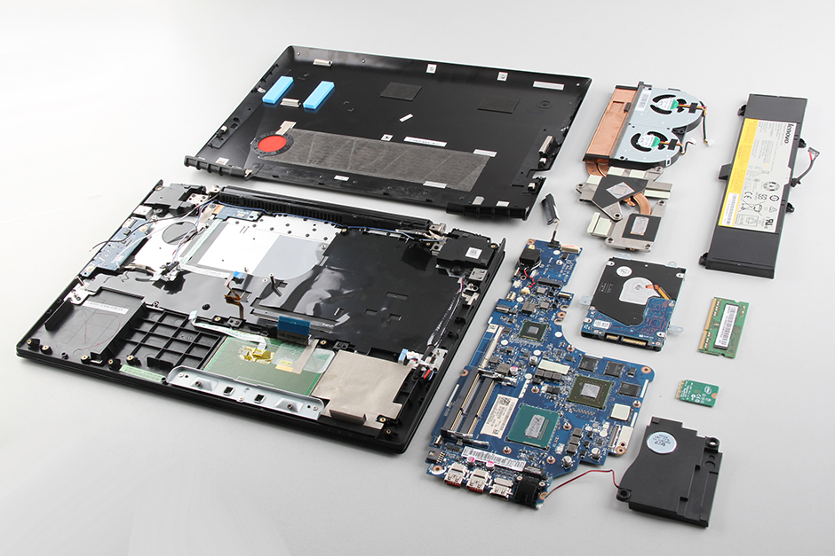

if this is what you see when you remove the back cover
the charging port seems to be a doughter board, so change the mainboard could be viable, but that depends on the specific layout of the mainboard you have, that y50 seems to be 3 or 5 models, not all of them share the same parts, this picture is for y50-70
http://www.myfixguide.com/manual/lenovo-y50-disassembly/
but this approach of change the daugter board is only doable if you confirm that the charger is not doing something funny here, and also if you already discarded the battery as the problem(which you report you did) and you find the part and that part has in it the charging port and the charging circuitry, on this model i am not sure, if that picture corresponds to your exact model
this is a high end model, so expect to find lots of troubles finding parts and the price will not be cheap

My laptop does use a flat port just to clarify and your images look exactly like my model

if the port only is the problem if the picture i posted corresponds, it seems viable if you find the right part, it seems to use only a couple screws and is separated from the mainboard
