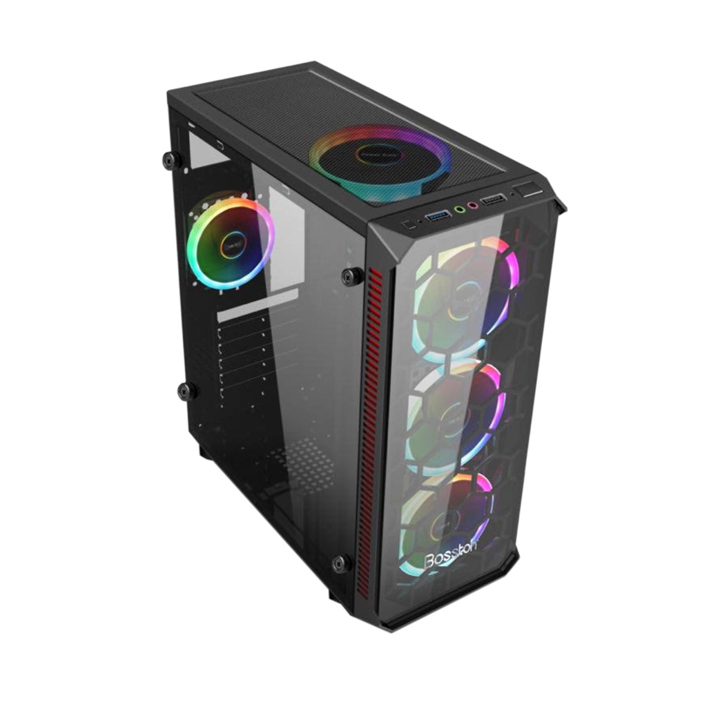

One of the reasons why i would like to get as much intake as i could is because my case has a front panel made with glass and only having side grills (Both sides). would i be better off modifying my side panel and turn it into a dust filter and make it in a way where i can mount fans on it and (which i think would be very doable) and put no fans on the front panel?
My case is very <Mod Edit>. Bosston cs 09
Ryzen 5 3600
Rx 5700
No cpu cooler yet. Ill buy one when i upgrade to rtx

Yeah i tend to overthink a lot. i forgot to mention one more thing. The worse thing about the case is that not just airflow is severely restricted by the front panel, the fan mount is also very poorly designed. Its like the fans are sandwiched with air flow restrictions. The other side is the glass front panel and on the other side is the fan mount where its not open at all. The fans have to be screwed on another layer of metal plane(yup, another metal plane, not just frame) which only has some holes on it. I failed miserably on choosing this case(online). T.T this is turning out to be a very challenging building experience.

I thought of that as well but its way harder to do. The glass is firmly attached to the frame where the buttons are. Whereas the side panel glass is just screwed onto the case. And as ive mentioned, the fan mounts are covering the fans as well. The fans are just mounted on a very weirdly shaped metal plane with randomly shaped holes on them.
