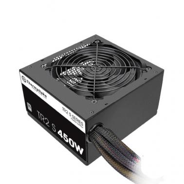

The build im planning on using this with is a i7 4770 and gtx 1060 6gb. The options i have are Antec Value Power 500P Plus 500W Power Supply Unit, SilverStone ST50F-ES230 Essential 230V 500W PSU 80+, Inwin 550W A55 80+ ATX Power Supply,Thermaltake TR2 S 450W 80PLUS Power Supply.

This is why I would not recommend those units.
See JG defending this specific series. You saying it's a shortcoming and him saying it's normal behaviour. Seems for the price a decent enough psu and since the OP only wants to spend a certain amount on that low budget build probably the best option he has.
"Normal behavior" does not necessarily equal "a good thing". I assure you, he does not recommend the use of those unless you don't mind that behavior. Almost everybody I've encountered with one of those units so far has come here asking why it does that and has ended up replacing it with something else because it's too annoying. Personally, I wouldn't want a unit that does that, at all.
I would rather have that the OP would spend more, but looking at the parts used does he look at low budget and i'd rather see him have something at least somewhat decent than him going to make his own choice between those he posted himself.
Recommending something twice the price isn't going to go well here but that's my opinion/guess.
The CX450m isn't twice the price, but I will concede that compared to the units originally posted, the v2 is probably a somewhat better choice, but it's still a unit that has problems. Even aside from the noise, it has issues with high ripple while in burst mode, and high ripple is always bad even if it's only during low loads. Personally, I don't want any unit in my machine with high ripple bombarding my graphics card and motherboard. A lot of premature failures on hardware are due not to manufacturing defects or user error, but capacitor failure from extended exposure to high ripple because of cheap power supplies.
But the other units mentioned are worse, so there is that.
