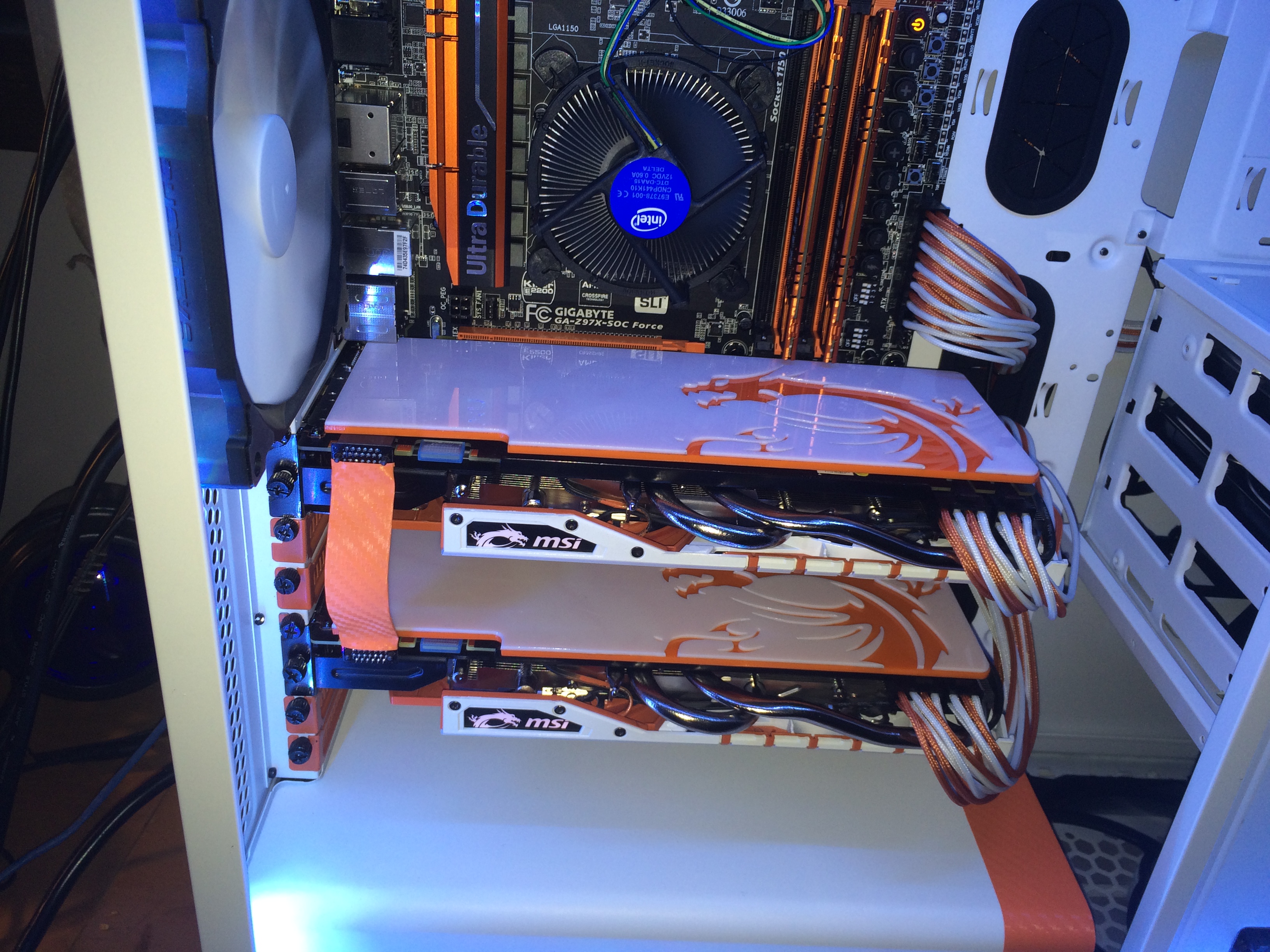

If ATX will work, I would suggest the Gigabyte GA-Z97X-SOC
http://pcpartpicker.com/product/R3V48d/gigabyte-motherboard-gaz97xsoc
My son has this boards and it provides a nice space separation between the 1st and 2nd SLI slot.
Here's some pics:
Air Cooled Build
2398399

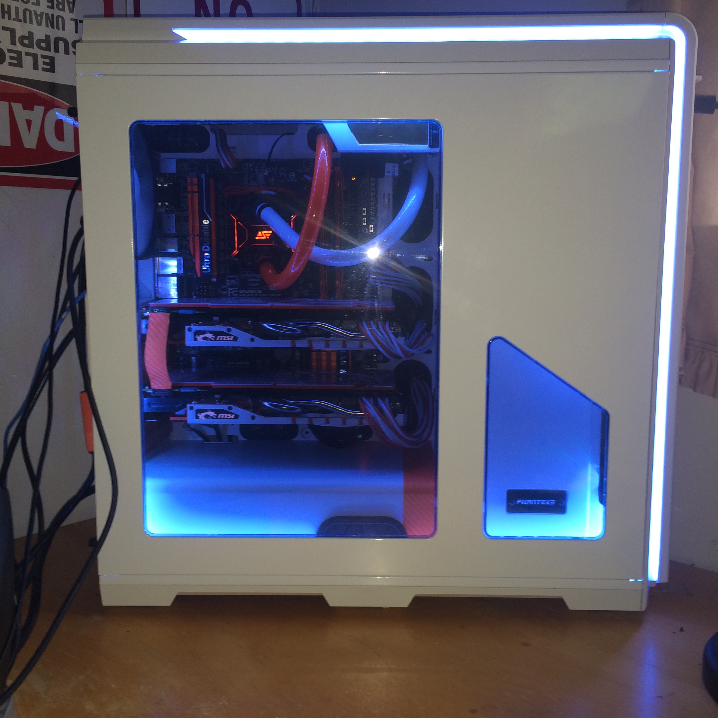

Water Cooled Build (before water cooler)
2415094
Water Cooled Build (after water cooler)
2446813
That case provides mounting holes for a 1200mm fan that was subsequently installed to blow air between the 2 cards ... you could I imagine do the same in your cases using one means or another but it dropped the temperature difference between the top card and bottom card from 10C to 0C.
