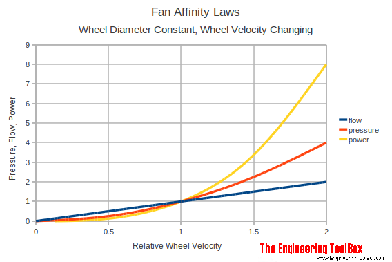

75 is quite hot though.
You can set it to 75% and see what happens. I'd guess pareto's law applies here as well.
Basically meaning that you get diminishing returns while the noise gets significantly louder when running the fan at 100% vs 80%
