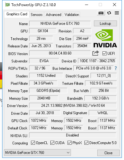

Hi, I have low TDP on games, with 99% of GPU usage, it makes the game go with low fps, however, when I run furmark it will reach the highest TDP, I had uninstalled the drivers with DDU and the same happens, high TDP on furmark but low in games, even if I put them to ultra settings

GPUZ screenshot: http://gpuz.techpowerup.com/18/08/21/kje.png

I think that I managed to fix it though, I had the 80.04.c4.00.60 bios version, I flashed the newer one (80.04.F0.00.60) and the fps now are 75 stable with vsync with everything as high as posible in that game, and with the TDP in furmark with the 8X MSAA option is not stuck in 75% now, so I guess that solved the problem
