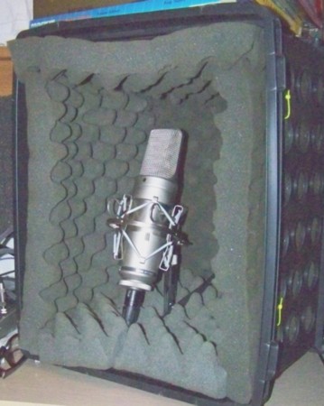

Then there's putting your mic in it's own sound booth or suspending something sound absorbing from your boom between mix and keyboard. Both of these options look ridiculous, but sorta work.
