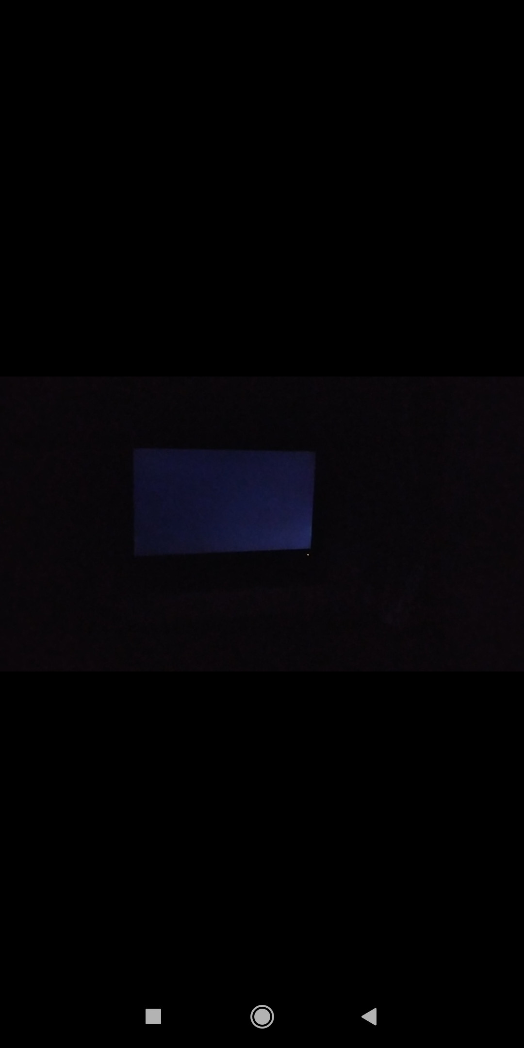

Anyway, ever since I got this monitor, I can't seem to keep it in standby, always when the pc is turned off, the backlight keeps coming on, even removing the power cord from my pc's power supply does not solve this, I have to either turn the monitor off or remove the dp cable. Have tried different dp ports on the gpu.
Anyone seen something like this, its very annoying, every few seconds it comes on like this, but the led on the monitor is still amber for stand-by.
Also, it seems to be less frequent if I unplugged the dp cable for a while and plug it back in.
https://iili.io/K50rcg.jpg
What could be the cause, I don't have another dp cable on hand.
Monitor is absolutely fine when using the pc though. This happens even if the pc is sleeping.

Oh I have bad luck, alright, this is the 4th montior on this pc, its insane, two had deadpixels, another piece had a gap between the bezel and screen, this one also developed a dead pixel after 9 months of use, it is the tiniest though, can't really find it even if I look for it, takes a little while to locate eventhough I know where it is.
Anyway, I've already reset the monitor to factory default multiple times, so not an issue with settings I guess. I've gone through all the settings to find something related, no luck there.
Could it just be the cable? I can't find anything like this even online, this montior has done it from the time I bought it, didn't bother taking it back to the store again, It was already the 4th one and without deadpixel at the time, I figured this is the best I was going to get.

No, it doesn't do it when the dp cable is removed, that is the only fix that has worked, remove dp, cable keep monitor powered on, its all fine. However, leaving the dp cable connected and removing the source of power for the dp cable, psu power cord, the issue persists.

Alright, removing the dp cable from the pc or the monitor solves the issue. However, a curious development, I started unpluggin all the other cables from the pc apart from the dp to see if something else was causing it as even removing the power cord from the psu didn't help, guess what, I unplussged everything and just left the ethernet cable and the dp cable connected, the monitor still kept doing it, but once I removed the ethernet cable, it stopped.
What is happening, is the ether cable waking my monitor, curiously, even removing the ethernet cable from the router doesn't help, only removing it from the pc solves the issue.

I held the power button on the pc after unplugging the power cord to power drain, it still happened, maybe that is not enough, Anyway, the option I mentioned is not withing the BIOS, it is under device manager in Windows for network adapter. That is what is confusing for me, how a windows setting changes behaviour when the pc is turned off, I even have the fast start up option disabled under powe options in Windows 10. But, the network adapter setting seems to have done the trick. Will keep observing though.
So, that wasn't it, back to sqaure one now, only unplugging the dp cable from one end, either the pc or monitor fixes this. It seemed fine for a day after the network adapter change, although less frequent it happened again. Ordering a DP cable now, I will update the post.
