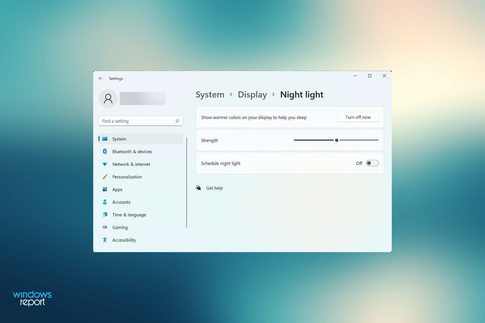

You may have already checked this but here it is anyway:
Go into Task Scheduler and make sure that Night Mode doesn't have a scheduled time to come on or anything.
There is also a reg edit for Night Mode not turning off (#5) at the link below that might prove beneficial:
Reactions: Hexabee
I did check to see if the schedule was on, it was not. I even reduced the strength slider all the way down just in case. I'll definitely check out the reg edit and new user profile options. Worst case scenario, I'm going to try reinstalling windows since it's a new build and there's nothing to back up.
You might also look into using BCUninstaller (Bulk Crap Uninstaller) to remove any bloatware but I don't think that is an issue since it's a custom install.
