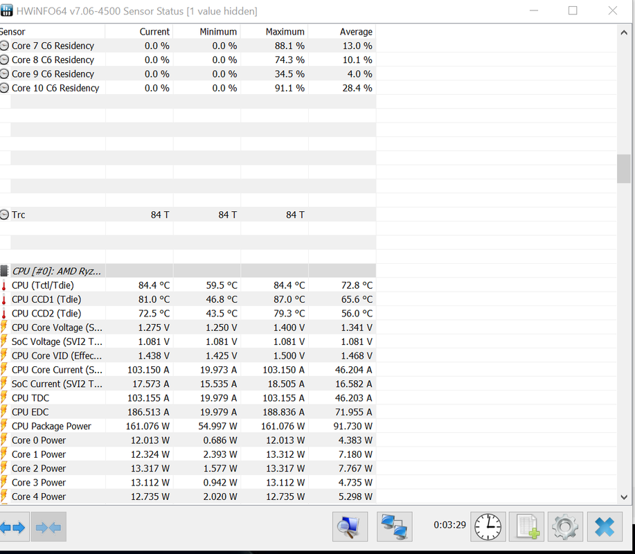

Hello Everyone,
I'm trying to play with EDC / TPC / PPT Values on my motherboard to lower done temperature of my ryzen 5900X, but it seems that whatever I set in the bios is not taken into account.
See picture belows.
I'm not using ryzen master or any other tool that does overclocking except NZXT CAM which to my knowledge should not change any of these.
Any idea ?
All setting those values do is open up limits. You have to run an appropriately heavy processsing load to actually push it to those limits. Even then it may never hit all the limits (and probably won't if you set them high enough) since the CPU's boosting algorithm won't let it if temperature isn't also being kept low enough.
If you want to limit how high temperature goes just set the platform thermal throttle limit to whatever you like.
The IMPORTANT temperature is NOT the 87C max reading on CCD1, but the AVERAGE temp.
What were you doing when you logged those temps? Run a heavy processing load (stress test) and watch AVERAGE. Be sure to reset the timer (the clock in lower right) after starting the stress test. Also compare PPT/TDC/EDC AVERAGE when running the test; also MAX as that's where you'll probably find it never exceeds the limits you set but only if cooling is adequate.

But what I don't understand is that max EDC / TDC is going above what I configured in the BIOS. I understood that this would be hard limit. Like EDC is reaching 188.8A while I configured 120 in BIOS.
I'm trying to decrease temp because during benchmarch or even during game, temperature can stay above 80c, resulting in a decrease of perfs.
The max readings are probably instantaneous spikes, meaning they don't last long. The average is probably more relevant too but better yet you can right click on each of the sensors for TDC, EDC and PPT and create a graph on the desktop to see how they track through time running various workloads.
But temps in the 80's are perfectly normal for a 5900X...up to 90C is not unexpected, although lower is always better of course. But anything you do in BIOS to force a lower temp means you're going to lose some performance to do so (some things more than others). If you want to keep temps down without hurting performance then you need better cooling.
