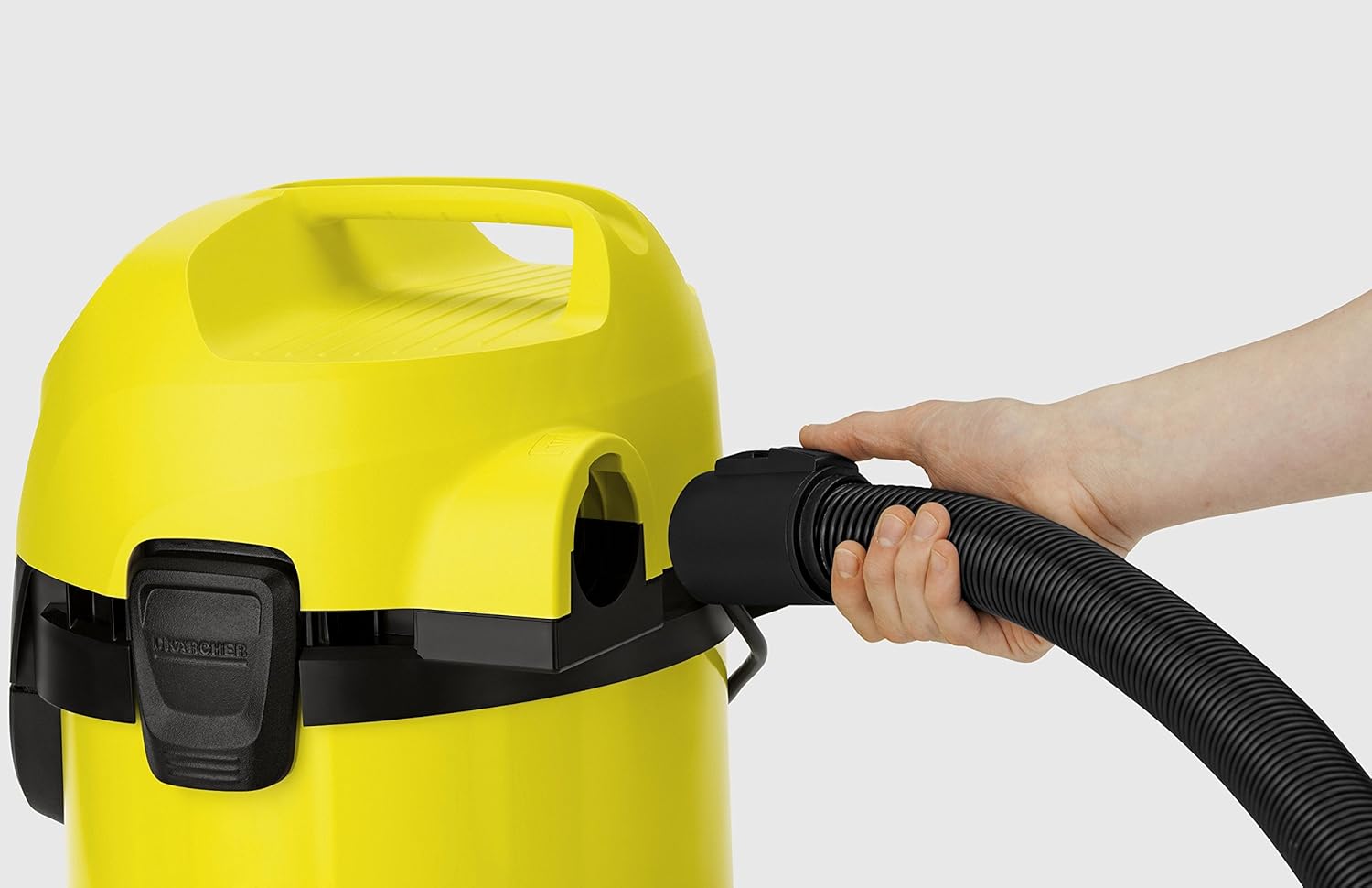

Not sure, isn't compressed air the best way to handle it? Or is using a vacuum cleaner fine?
Vacuuming is a terrible thing to do. It creates a lot of static. I always just use a compressor to blow dust out of my pc.
Static? With plastic? LOL, compressor blows more air and can spin up fans more than regular vacuum cleaner (unless disconnected or wont burn out)
And while doing this to PSU please stop it with wooden stick or something (NOT METAL), i've cleaned it with vacuum and typing right now (if you INSIST i can record this).
