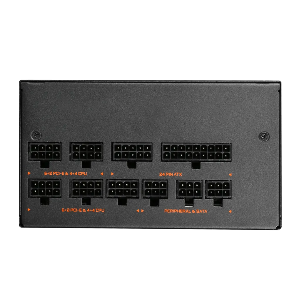

7
Cpu cable is in top row second from left.
