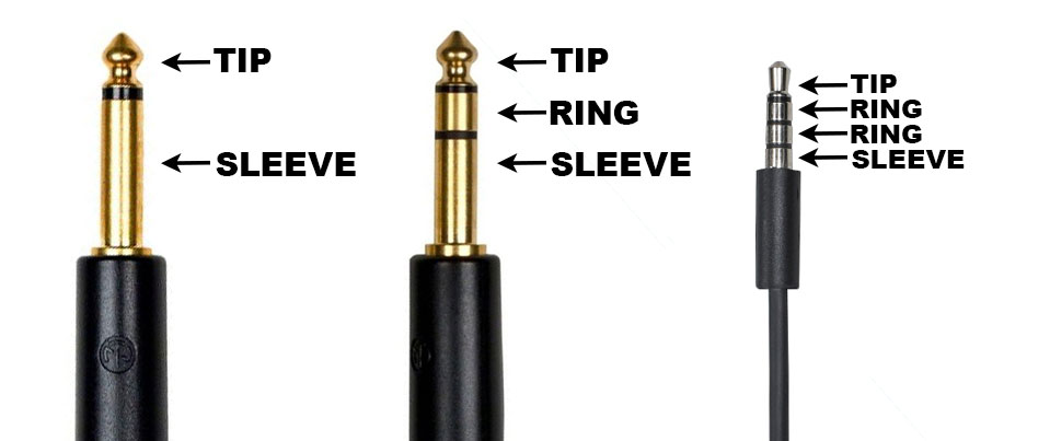

I'm asking because you mentioned that the earphones work with your phone. Are these earphones including microphones with a TRRS plug, which will never work with a computer? How many rings are there in the plug?

The one in the middle is the correct design for a computer, tip, ring, sleeve. The one on the right is for a phone.
They all TRRS, you sure they don't work on computer man?
Cause they definitely worked just fine on my computer before.
And they work just fine on my office computer.
