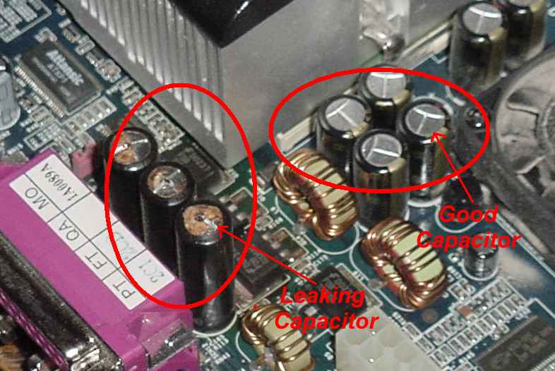

It certainly could be an issue with the motherboard, yes. There will likely be some obvious physical damage though, if the MB is the culprit.
Inspect the board, look for bulging or leaking capacitors.... or anything else that looks 'wrong'... Burn marks etc.

All the capacitors look fine, will try with a working PSU, then see what happens. Thanks a lot really for your help. 👍
